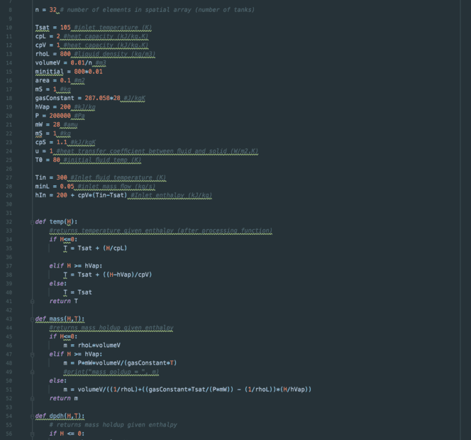

In the present version of the multi-tank model, the balance equations read: $$\dot{m}_{i}=\dot{m}_{i-1}-\frac{V}{n}\frac{d\rho_i}{dt}$$$$\frac{V}{n}\rho_i\frac{dh_i}{dt}=\dot{m}_{i-1}(h_{i-1}-h_i)+U\frac{A}{n}(T_{S,i}-T_i)$$and$$\frac{m_s}{n}\frac{dT_{S,i}}{dt}=-U\frac{A}{n}(T_{S,i}-T_i)$$where V is the total pore volume in the bed and A is the total heat transfer area in the bed.
If we multiply all three of these equations by the number of tanks n, we obtain:$$\dot{M}_{i}=\dot{M}_{i-1}-V\frac{d\rho_i}{dt}$$$$(V\rho_i)\frac{dh_i}{dt}=\dot{M}_{i-1}(h_{i-1}-h_i)+UA(T_{S,i}-T_i)$$and$$m_s\frac{dT_{S,i}}{dt}=-UA(T_{S,i}-T_i)$$where $$\dot{M}_i=n\dot{m}_i$$These equations tell us that the multi-tank model is equivalent mathematically to a tanks-in-series-model in which each tank in the series is identical to the single tank model of the entire packed bed, but with the mass flow rate to the first tank in the series equal to n times the actual mass flow rate to the bed. This form of the model is much easier to code than the present version of the model because much of the code can be extracted from the single tank model (plus we don't have to divide everything by n), less error prone, and it is much easier to conceptualize. What do you think?
  • #219
I follow the reasoning almost completely except the mass flow point here is slightly confusing. So you say the multi-tank model is equivalent mathematically to a tanks in series model. I follow this. It means we can model each individual tank in the multi-tank model the same way the single tank is modeled. So essentially we'll have n single tank models in series, and this is equivalent to the multi-tank model.
This bit though - so we'll have the mass flow to the first tank actually equal to say 0.05kg/s, however we want to multiply this value by n. So capital ##M## is not really the mass flow, its a kind of total flow through the system value. So we will be solving for capital ##M## at all spatial points in the system, and to find the mass flow array we would just need to divide by n? This would make sense to me. Does this M term have physical significance?
I can code this model up. For this model as we're extracting code from the single tank model, I think it makes sense to finish the analytical solution for the liquid phase single tank model first. I'm actually working on the analytical solution currently. Then once its clear the numerical solution to the single tank checks out, I can use this code for the multi-tank modeled you've detailed above. How does this approach sound?

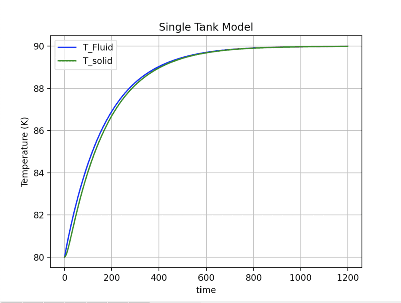

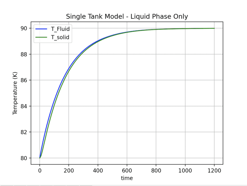

Hi Chet, update on the analytical solution:
I haven't been able to actually derive the analytical solution myself yet (seems more difficult than I first anticipated), however Mathematica does this and has solved the equations both numerically and analytically. I'll transfer the analytical solution functions (if correct) to Python. Here is the output for fluid temperature versus time (I have the solid plot also, its basically the same):
You can see the constant values I used, plus the T(t) and Ts(t) analytical solution functions output by Mathematica (the functions are blurry so I've typed them out at the bottom), and also the analytical solution graph from 0 to 3000s. Note it seems to curve off unexpectedly just before 3000s.
Here is the numerical solution, also done by Mathematica. The plot starts out similar to the analytical one, and continues to level off towards the inlet temperature indefinitely, which seems to make more physical sense. There is no unusual decrease in temperature behaviour happening in the numerical solution
Its late here so I'm going to check these plots against my own code first thing tomorrow.

Their analytic solution is very puzzling because there are only two eigenvalues to the characteristic equation. Here is the eigenvalue equation I came up with: $$\lambda^2+\left[\frac{\dot{m}_{in}}{m}+\frac{UA}{mC}+\frac{UA}{m_sC_s}\right]\lambda+\frac{\dot{m}_{in}}{m}\frac{UA}{m_sC_s}=0$$
For the parameter values you showed in your printout, this gives $$\lambda=-0.0133$$and$$\lambda=-0.000738$$which matches their values (at least on the two main terms). This implies a time constant at long times of 1/0.000738=1355 sec.
Let's see how your numerical solution compares to their analytic solution..

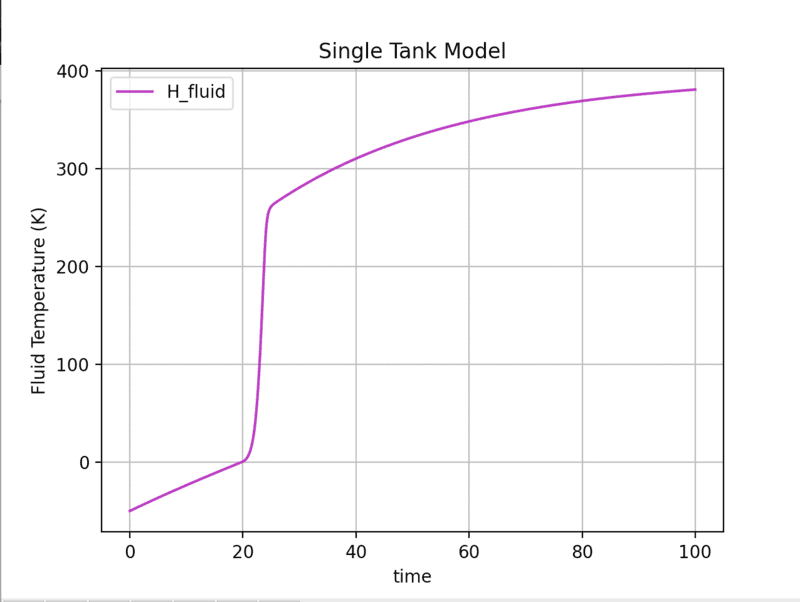

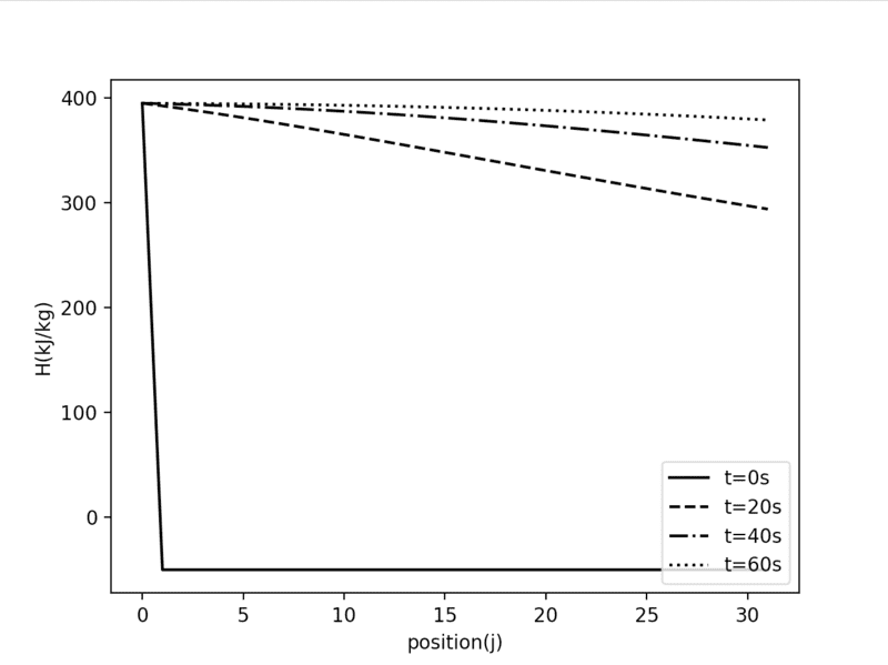

The analytical and numerical solutions from Mathematica now match. The problem was in how Mathematica deals with decimal numbers. So the graphs of T and Ts vs time now match.
And here is the analytical solution:
Editing my numerical solution now to compare.
There we go, my numerical solution does seem to match the Mathematica one:

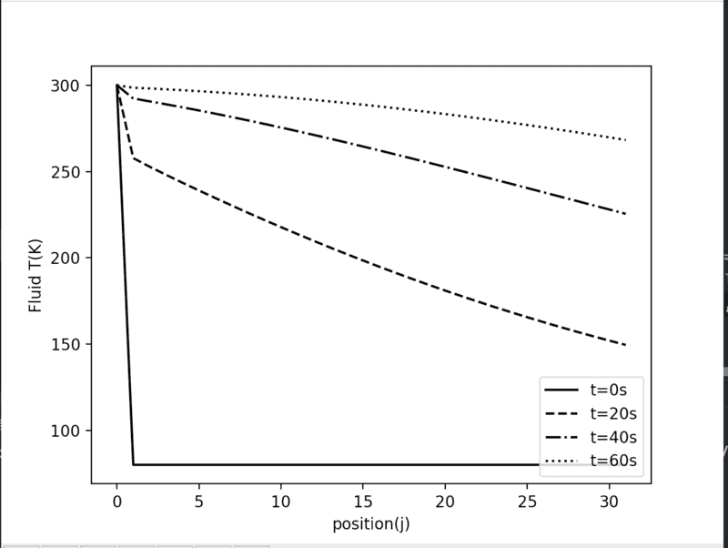

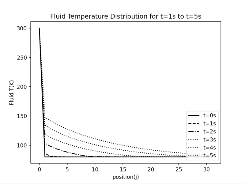

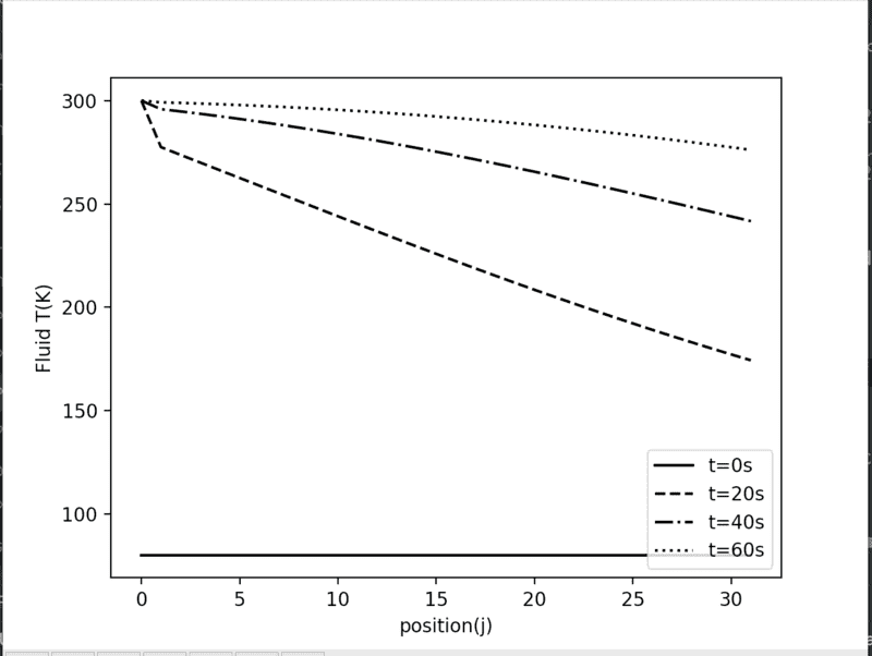

And here is the plot for the liquid phase temperature, using the spatial variation model, assuming n=2 (so the inlet conditions plus one spatial point). Ignoring the jumps, This also matches the other plots:
Note the time is x1000 (due to 1000 points calculated per time step) so dividing the x-axis values by 1000 gives the same values as the previous plots

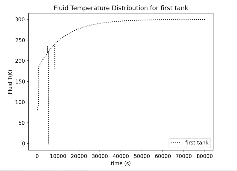

And lastly, I've set n = 32 and plotted the final position (index 31) versus time:
This also roughly matches the timescale of the other plots. Is this all reasonable to you?

How about running the 3 tank version and plotting temperature vs time on the same graph for all three tanks? Don’t you expect a time delay between subsequent tank time responses as the wave travels through the bed?
  • #229

Here we go, this is for n=4. I went with n=4 so we can see three inner-tank Tf vs t graphs, position 0 is just the inlet condition.
As you mentioned we can see the time delay across the tank. The plot is quite messy due to these 'numerical bumps'. The output does look similar to the analytical and numerical output from Mathematica though.
Reverting back to the two phase model (assuming liquid in the tank, with a gas 300K input). Heres the graph for n=4. This also seems to approximately matches the timescale of the others:
Am I correct in saying this means that the spatial variation model is correct? i.e. no particular need to move to the model you outlined yesterday? I will code this up anyway but it seems the original spatial variation model is ok?
  • #231
What are the actual times on the time axis? Is 1 the same as 1000 seconds? If so, can you please show the results only up to the 1000 seconds part (so 1000 is the full horizontal range)? Also, can you please include the single tank model results for the entire bed for comparison? All this for the liquid only case. Thanks.

Can do, this is both graphs above, to 1000s, for the liquid phase only (90K inlet stream, bed initial temperature of 80K).
Single tank:
Spatial variation plot: for n=4:
The single tank plot seems to best match the first position here.

  • #237
casualguitar said:
Here we go, this is a 3x flowrate plot for the single tank model. So the flow here is 0.15kg/s. Everything else is the same:
I will look into this overlay plot now. There is almost definitely a convenient way to do this
This is what the first tank in the 3 tank model should give. Does it?

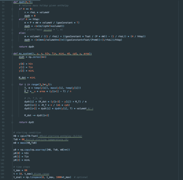

  • #244
I have a feeling that the thing that is causing your numerical problems is the overall mass balance for each tank.
Are you still using an automatic integrator, and calculating the time derivative of the entire solution vector all at once for the integrator to use? If so, do you have the solution vector as the column vector ordered as ##h_1,T_{S,1}, h_2, T_{S,2},h_3, T_{S,3},...##?
If you are using this scheme, you calculate the time derivative of ##h_1## for the first tank using ##\dot{m}_0## which does not change with time. Then you calculate ##\dot{m}_1## exiting tank 1 and entering tank 2 using the mass balance equation with the time derivative of ##h_1## that you just calculated for the first tank. Then you use this value of ##\dot{m}_1## entering tank 2 to calculate the time derivative of ##h_2## for the second tank. Then you calculate ##\dot{m}_2## exiting tank 2 and entering tank 3 using the mass balance equation with the time derivative of ##h_2## that you just calculated for the second tank. Then you use this value of ##\dot{m}_2## entering tank 3 to calculate the time derivative of ##h_3## for the third tank. etc. In the end, you will have all the time derivatives of the h's in all the tanks, which gets loaded into the time derivative vector. And, of course, in each of these steps you are also calculating the time derivative of the bed temperature for the specific tank, and also loading this into the derivative vector.
Is this what you are doing? If not, what is the scheme that you are applying?
  • #245
Hi Chet, I had a separate report to finish today so I'm starting this now.
Chestermiller said:
Are you still using an automatic integrator, and calculating the time derivative of the entire solution vector all at once for the integrator to use? If so, do you have the solution vector as the column vector ordered as h1,TS,1,h2,TS,2,h3,TS,3,...?
Yes to all this, except the solution vector is ##h1,TS1,m1,etc## where m1 is the flowrate. The way I've set up the mass holdup and mass flow does look suspect to me. I don't think this affects the solution but I could remove this from the solution vector in case I'm doing something wrong there in the setup
Chestermiller said:
If you are using this scheme, you calculate the time derivative of h1 for the first tank using m˙0 which does not change with time. Then you calculate m˙1 exiting tank 1 and entering tank 2 using the mass balance equation with the time derivative of h1 that you just calculated for the first tank. Then you use this value of m˙1 entering tank 2 to calculate the time derivative of h2 for the second tank. Then you calculate m˙2 exiting tank 2 and entering tank 3 using the mass balance equation with the time derivative of h2 that you just calculated for the second tank. Then you use this value of m˙2 entering tank 3 to calculate the time derivative of h3 for the third tank. etc. In the end, you will have all the time derivatives of the h's in all the tanks, which gets loaded into the time derivative vector.
Yes to all of this, as far as I know I'm following this exact scheme unless the error is that I've coded this scheme incorrectly
Instead of this I'm just taking the solid energy balance, and generating the fluid temperature vector afterwards. The Ts array is known so I generate the dTs/dt array also and get the fluid temperature array from this. This image shows the flow for that:
I'll go for removing m from the solution array first
