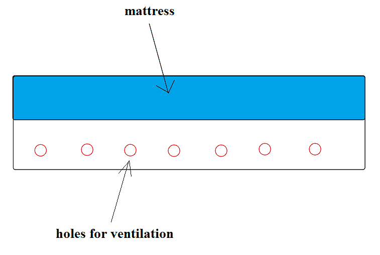

Tnx for the answers. Ok, i will give just an example to maybe make things easier to understand. This is just an example, so no bed advices please, this is not about a bed :biggrin:
So for this one example, i picked an average bed i found on google. Its perfect since its basicaly a small wooden box with some holes on the side or gap on the bottom and a heat & humidity source on top (person lying on matress).
Ok, so under the matress the air will be hotter than elsewhere since human body produces heat. And it will also be more moist since human body sweats (probably relative humidity will be higher even though air will be hotter meaning air will hold more water vapor on top than on the bottom). Now the level of this depends on many factors, type of bed, ventilation, person, etc. All that is not important. What i want to know through this case is how air behaves. We know that hot air will rise and cold air will drop. We also know that humid air will rise and less humid air will drop. So since we have both heat and humidity near the top of the box (in our case matress), does that mean that essentially hot and humid air will just float near the top of the box and it will have no "motivation" to actualy leave the box or exchange with the air outside the box ? How would that be different than for instance if we had heat and humidity on the bottom of the box (in this case this would mean matress is on the floor and the poor person is lying under it). Now we could actualy feel the air mass moving from bottom of the box to top of the box right ?
I am sorry if i complicated it to much but with heat alone it is much easier to understand since you can actualy feel it with hand, even just opening a fridge and putting hand under it, you can feel the cold air flowing through your fingers. With humidity it seems a lot more subtle of a movement and its really hard to detect.
These are not good assumptions from which to start.
Mattresses are pretty thick. I doubt much human body heat would be conducted through a six inch mattress. And I'm certain no water vapour would be.
SentinelAeon said:
Ok, so under the matress the air will be hotter than elsewhere since human body produces heat. And it will also be more moist since human body sweats.
I don't think that is true.
More moisture will be lost by breath than by sweating while sleeping. The blanket and mattress of the bed tend to be insulators that reduce metabolism and body cooling to be by breathing, not sweating.
If the air in the bedroom is still, and cool at night, the heat and moisture from the breath of a person in bed, form a column of rising air that flows upwards from their head, to a small area of the ceiling of the bedroom, where it spreads out across the surface, cools, and then falls down the walls to circulate again.
An inner-spring mattress has an open inner-space that allows stagnation of internal air, that prevents heat and moisture moving downwards.
A foam mattress has reduced internal flow, and is thinner under a person, so heat and moisture can soak downwards in the much reduced airflow. That fits better with your statement I quoted above.
Cold and dry air stagnates under the bed, which is why beds in cold climates originally had long legs before houses became well insulated and air-conditioned. In hot climates, a mattress on the floor is cooler than a bed with legs. Never sleep on the floor in a place with cold still air, as that is where the coldest and driest air stagnates, with most accumulated CO2.
Bed details are so varied, that only a specific case can be discussed in a specific climate. There can be generalisations, but not with detailed analysis.
