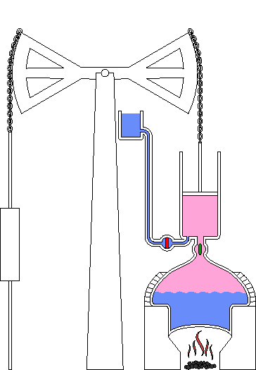

Thomas Newcomen invented the first steam engine in 1712:
http://en.wikipedia.org/wiki/Newcomen_atmospheric_engine

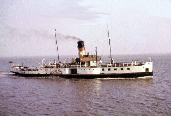

Arguably, the real breakthrough for engine-powered boats was the screw propeller replacing the paddle wheel - though paddle wheels survived for a long time. Three of these boats operated the river Humber ferry in the UK until the suspension bridge (still the 7th longest in the world) was completed in 1981.
