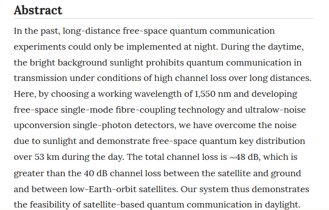

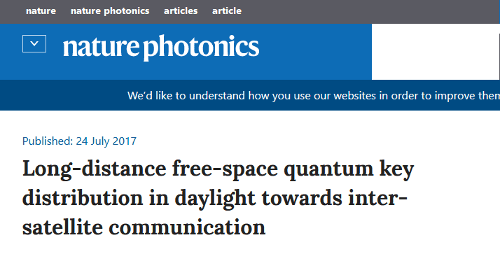

What about free space QKD? Here lasers ARE used for terrestrial-to-satellite communication.
It is currently a hot topic and it is growing very quickly, the first experimental demonstration was done by the Chinese (who has a satellite specifically made for this) quite recently.
Of course this would need to be theoretical project, but I suspect you could do a fair amount of interesting modelling.
Likes berkeman
Interesting, thanks for the info. Here is a paper that I found with a quick Google search:
https://www.nature.com/articles/nphoton.2017.116
