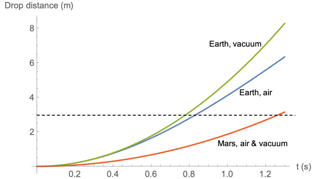

Well, I solved the ODE and obtained expressions for ##v(t)## and ##x(t)##. Here is a summary of results that substantiate @haruspex's approximations.
Earth
Using the official mass [https://en.wikipedia.org/wiki/Table_tennis#Ball] of 2.7 g and radius 20 mm for the ping-pong ball, I got a terminal velocity of 8.64 m/s which agrees with the value mentioned in the link in post #22. I then solved for the time of flight numerically and went back to find the speed at that time. As expected, I got a number less than ##\sqrt{2g_{Earth}h}=7.7~\mathrm{m/s}##.
Mars
Repeated the above for Mars. Terminal velocity on Mars is 69 m/s. I then solved for the time of flight numerically and got and went back to find the speed at that time. As expected I got a number extremely close to ##\sqrt{2 g_{Mars}h}=4.73~\mathrm{m/s}##.
Finally, the graph below shows Drop distance vs. time on Earth and on Mars in air and in vacuum ( i.e. neglecting air resistance). On Mars, the air is so thin that it makes no difference as already explained by @haruspex.
I agree that the expectation is not that one solve the ODE. Perhaps it is a test as to how inventive and realistic one's answer is.
