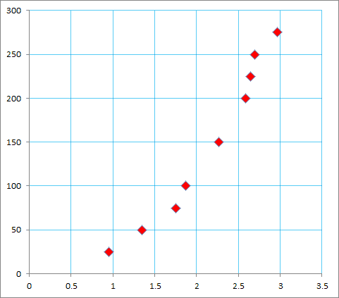

I am evaluating, the problem is I can't incorporate the drag equation into the model just as you said it was difficult to solve. For context, the timings were done manually with stopwatches and the plane was made out of smooth wood, slightly convex so a bit of outliers due to oscillations. For results, (x,y) refers to (time(s),displacement(cm)) : (0.95,25) (1.35,50) (1.75,75) (1.87,100) (2.27,150) ( (2.59,200) (2.65,225) (2.7,250) (2.97, 275) I have excluded some outliers but that's the raw data anyways. Thx for asking

On the basis of what argument have you excluded your outliers ?

Oh its like ones that go crazy, say different displacement same time which would make the graph not even a function.
That's not really a good reason to exclude outliers. The appropriate way to do it is to include errors in the measurements and do a statistical analysis.

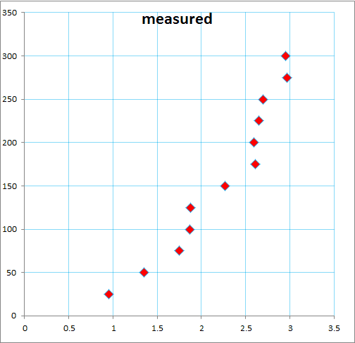

I went to calculate the model with air resistance, I do not know how to include KE lost to angular momentum yet. And the model gave me a concave down parabola which is not supposed to happen right? I used the formula Fnet= Fgravity-Fdrag and the drag formula I used was F=-bv^2. b was 0.7 ish for my marble and I differentiated acceleration due to gravity for the velocity, is that even correct? Anyways, Fnet turned out to be negative so any reasons why this has gone ridiculously wrong? Thanks for the outlier tip btw, (1.88, 125) (2.61, 175) (2.95, 300) here are the ones I excluded.
So why exclude actual measurements ?
