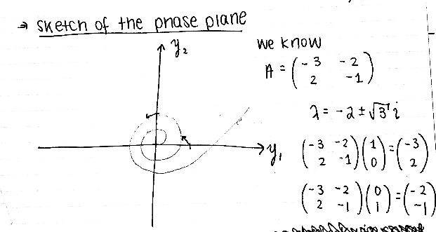

Is the spiral I drew here clockwise or counterclockwise ? What’s a trick to know whether it’s going CCW or CW. Thanks!

The ODE system looks something like this ##y' = A y##. Let's pick ##y_2 = 0, y_1 = 1##, which implies ##y' = \langle-3,2\rangle##. This implies at the point ##(1,0)## in the phase plane there will be a vector pointing in the direction ##\langle -3,2\rangle##, and hence moving in the direction along the spiral away from the center.

Im not quite sure if that means all solns would be approaching the center? Clockwise or Counterclockwise

Plot several points and you'll see the behavior, such as the point ##(y_1 = a > 0, y_2 = 0)##. Alternatively, look at the sign of the real component of the eigenvalue to determine whether or not solutions converge to the origin or not.
