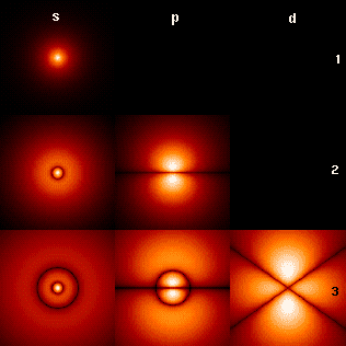

The OP should find the Wikepedia article helpful. https://en.wikipedia.org/wiki/Atomic_orbital
From the article this figure shows that the size and shape of orbitals is fuzzy and probabilistic. You can't express that with a single number. False-color density images of some hydrogen-like atomic orbitals
And this figure shows that the shape is not static.

By assuming non-interacting electrons, helium's 1s should be smaller since the nuclear attraction is larger.
darkdave3000 said:
So the probability of finding an electrion in that double density cloud would be doubled.
Yes, approximately.

It has been solved exactly for any of its shells, why? Because the relevant Schroedinger equation can be analitically solved. What does solving all shells for hydrogen mean? This means you can calculate the probability density for any shell.
darkdave3000 said:
What are my problems that you see for me to graft a 3D picture for helium vs hydrogen?
At first I thought you need to do a rigorous rendering of the wavefunctions, now I realize that you just want to plot the shells without use of too much exactness. In this case, go on with the non-interacting model of atom I have talked before. Just use the shell formula for hydrogen but change the nuclear charge.

I think that one difficulty with your project is that there is no simple passage from hydrogen to other atoms. Adding even a single electron completely changes the problem at hand, and makes its solution much more difficult.
You can either simply use the results of hydrogen and scale them, but this is not satisfactory as it neglects the electron-electron interaction (so there is basically no point in plotting something else than hydrogen). The other possibility is to use a computational chemistry program to calculate single-electron orbitals for multi-electron atoms, and use that to create the plots.

Meaning that the 1s1 in hydrogen is not a perfect sphere. More like a cratered planet. If in 2 dimension analogy its a 2D wave that amplifies it self with constructive inteference youre going to have exaggerated peaks and drops everywhere in a 3D model like a crattered moon. Am I right?
I don't believe so. As far as I am aware, the electron is indeed in a perfectly spherical shell.
