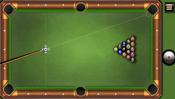

1) Can the contact between two pool balls impart any kind of spin, other that about its horizontal axis due friction contact with the table surface?
2) If a ball is in motion (traveling in a straight line) and contacts a cushion, can that contact impart spin to the ball such that when leaving the cushion, is path (when viewed from above) forms an arc?
Background: I love playing pool, but in lock-down I've taken to playing pool against my computer. I've found a version that isn't to annoying, but in addition to various simple bugs (like a ball managing to end up balanced on the frame of the table) is has this curious behavior that if you hit a ball hard such that it ricochets around that table without contacting any other balls or going in a pocket, after the second or third contact, it starts moving in an arc.
Including a couple of times when it skipped along a long cushion much like a stone skipped on a pond. Ie.Hitting a cushion, bouncing away and then moving in an arg to come back to the same cushion without hitting anything else. Two and even three times.
I am pretty sure I've never seen this IRL; and my instinct says that it is physically possible. I'm seeking to verify that instinct.
I'm aware of (and can do IRL) swerve & masse shot by applying spin (English) to the cue ball when you strike it; but despite that I used the cue ball in the demo above, (its much easier to capture) no spin was applied.
Also, if you look closely, the ball's path from the strike to the first cushion -- and between the first and second, and the second and third contacts -- is straight.
It is only after the third cushion contact that the curved path appears, implying that it is contact with the cushion that is adding the spin. And I believe that to be physically impossible.
Here's another, more extreme example, also using the cue ball for convenience, but this time I've included the spin control showing the red contact spot is dead central, so no spin applied. I've also slowed it down x10:
Buk said:
1) When two smooth surfaced balls contact each other, the forces always act directly through the centers of mass, thus no spin can be imparted.
This ignores friction, which can impart spin, because it doesn't act through the center of mass
Buk said:
2) When a ball hits a cushion, any existing spin (about its vertical axis), will act to change the angle at which it leaves the cushion; and the contact will reduce the moment about that vertical axis -- friction lost to the cushion -- but no additional spin (about the vertical axis) will be imparted to the ball by the contact.
Depending on the initial spin direction and the relative collision velocities, the spin can be increased or decreased by a collision
Can I take that you are suggesting that if (say) the cue ball has spin around its vertical axis at the moment it hits the object ball; some portion of that spin will be transferred to the object ball (presumable in the opposite rotation like meshing gears) during that brief moment of contact between them?
Let's assume for now that the cue ball is spinning at 60rpm around its vertical axis. And the contact between the two balls lasts 0.1s. If the friction contact between them was perfect (gear mesh line) then both balls would rotate 36° in opposite directions during that 0.1s.
But I believe (but cannot currently cite) that the contact period is far, far less; and that the percentage of that period when friction between them is sufficient to transmit motion less still.
I find really hard to imagine any significant amount of spin being transferred; but it'll have to wait until my lock-down ends before I can get near a pool table to experiment.
Thanks for the thought experiment.
Yes, but the friction coefficient between two balls is less than between ball and side cushion. So smaller spin changes are to be expected for ball on ball collisions.
In collisions, shorter contact period means also greater normal force, and thus greater frictional force.
