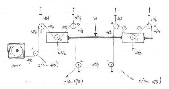

In summary, Steve is having difficulty figuring out how to support a weight with a pulley system. He needs someone to review his sketch and tell him if he is close. He also needs to figure out the force multiplier of his pulleys.

Hi All,
I am an old dog, and rusty propeller head. I am having the most difficult time figuring out the forces on a pulley system I am working on. Can someone please review my sketch and tell me if I am even close. I would accept any suggestions and direction.
Much Obliged
-Steve
How can you support W/2 with two strings of W/8 tension (in addition, they have some angle between them!)
In addition, what happens to the end of the string (right side)? I think it should help to support the weight, too.
W/8 is a force, the tangent of a force is not well-defined.
Yes, I knew my W/2 did not add up correctly with 2 - W/8 loads. That is really where I need help.
W = Load
W/2 is a pulley at each end of the W
The angle is not counted at this time to avoid further confusion.
The end of the string is lifting W
I drew the tangent of middle pulleys for reference. The load on them will not affect my system I am building. I can calculate the load after I correctly figure out the force multiplier of my pulleys.
I hope I helped clear some up your questions.
The end of the string is lifting the same as all other parts. If we approximate that those string elements are vertical, we have 5 times the string tension holding that weight W, so string tension is W/5.
Thank you,
So that I have more understanding...
Is the weight only carried by the string between pulleys B-C, C-D, G-H, H-I , I-to end?
Also; Is my W/2 at pulleys C and H correct?
Do I substitute W/5 for where I have W/8 throughout the string?
-Steve
As the other parts are not connected to the weight... sure.
No, as you did not consider the end here.
Right
Thank you !
I believe I have all that I need.
Peace.
