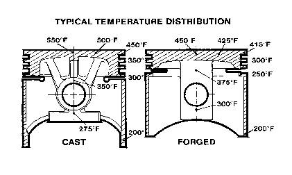

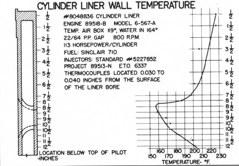

engine oil does a lot of important things besides lubricating. It is a major requirement to cool the rotating and reciprocating components as well as clean any material debris. The oil squirting out of the connecting rod bearings slings all over the cylinder and soils the piston wrist pin. Its must carry away 500 degree F heat from the bottom of the piston. It must carry away heat from the cylinder walls. Once the engine reaches full operating temperature the oil temperature in the oil pan will be relatively stable.
