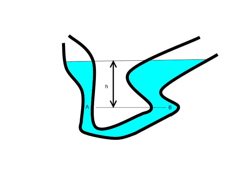

So, is that what happens, then? The bottle could be absolutely any shape and all that matters is the height to the top? I have a lab on this, and although I didn't take any data on the slanted part of the bottle I still need to say definitively if it matters whether data is taken on the slanted part or not. If you were graphing pressure against water height on an irregularly-slanted bottle, would the relationship still be linear across all parts of the bottle?
The slanted side of the bottle has water pressure pressing against it, and it presses back on the water. The pressure force applied by the slanted side to the water is oriented perpendicular to the slanted side, so it has a component in the downward direction. This applies a downward force on the fluid below.
You also need to be aware of Pascal's law. It is based on observation, and says that, at a given spatial location in the water, the pressure acts equally in all directions. So, at a given depth the pressure is acting horizontally also. If you have a continuous vertical column of water away from the sides, you can get the pressure at the bottom of that column. That pressure is also acting horizontally, and the pressure does not change in the horizontal direction (from a horizontal force balance). So, the pressure at the bottom of the column is also transmitted horizontally to the slanted walls of the bottle. So the only thing that matters is the depth below the upper surface.

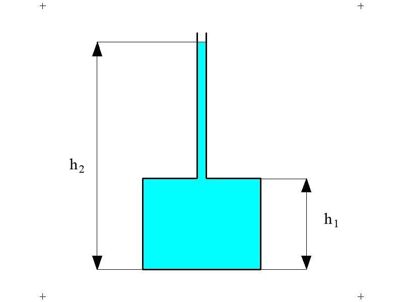

There's a variation of the hydrostatic paradox, where the pressure in a barrel is increased by adding a small but long tube to the top and filling the tube with water, until the barrel bursts. It might not be intuitive how a narrow tube of water can contribute so much to the pressure in a much larger barrel. (Of course, if the tube is too narrow, then there will be capillary action which complicates things.)

I didn't understand single bit of it. Pls help what you are trying to say; a schematic diagram would do wonder for me.
There is no paradox .
Hint : Think about energy as well as pressure .
Likes Ravi Singh choudhary
That's why I love physics; very non-intuitive yet fascinating. Thanks for the picture
See..
