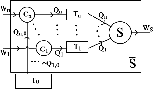

It sounds like you are talking about the proof of the Clausius inequality. Namely, that if during a cycle C a system is successively in contact with heat sources at temperatures T1, T2,..., Tn, and if the system absorbs heat Qj (which can be positive or negative) from source Tj, then for the cycle we have
$$ \sum_{j=1}^n \frac {Q_j}{T_j} \leq 0$$
This can be shown by combining the cycle C with n reversible Carnot cycles C1, C2,..., Cn. The Carnot cycle Cj operates between some reference temperature T0 and Tj and is sized so that it delivers heat Qj to source Tj and absorbs heat Q0,j from source T0. The net result of cycle C combined with the Carnot cycles is to absorb heat
$$ Q_0 = \sum_{j=1}^n Q_{0,j} $$
from source T0 and convert it into work. Kelvin's postulate (of the second law) says that this quantity can't be positive--because then you'd have a process that did nothing other than convert heat from one temperature into work.
For each Carnot cycle, we have that
$$ \frac{Q_{0,j}}{Q_j} = \frac {T_0}{T_j} $$
Thus
$$ Q_0 = \sum_{j=1}^n Q_{0,j} = T_0 \sum_{j=1}^n \frac {Q_j}{T_j} \leq 0$$
If the cycle C is reversible, then you can reverse the whole combined process and prove that Q_0 >= 0 also. Combining it with the above inequality, you get that
$$ \sum_{j=1}^n \frac {Q_j}{T_j} = 0 $$

At least in the proof I gave, I don't think it the cycle C was really approximated by the Carnot cycles C1, C2,..., Cn. It is simply combined with them to make one complex cycle C + C1 + C2 + ... + Cn so that we can prove Clausius' inequality
When you pass to the limit of a continuum of different heat sources, from each of which the system absorbs dQ(T) of heat, this inequality becomes
$$ \int_C \frac{dQ}{T} \leq 0$$
When the cycle C is reversible, the inequality becomes an equality:
$$ \int_C \frac{dQ}{T} = 0$$
Since the cycle C here is reversible, we have that dQ/T = dS. The above equation says that the total change in entropy of a reversible cycle is zero, which is what you wanted to prove. Is it possible that your book was speaking informally when it said you can conclude this by approximating the cycle C by a sum of Carnot cycles? Does it actually offer a proof?

Well, that is actually what I proved, although I admit it is hard to follow that proof without a picture to look at. Maybe I can dig one up. It is a tricky proof, one that I had to go over several times before I got the point of it. I know that Feynman Lectures Vol 1 has a picture of what I'm talking about, if you can get hold of that.
In fact what I showed was even more general. That for any cycle at all, reversible or irreversible, we have that
In the special case of reversible cycles (which don't have to be Carnot cycles), you can also conclude that
\int_C \frac{dQ}{T} \geq 0
simply by reversing the cycle, which has the effect of replacing dQ with -dQ. That is, if in the forward cycle the system absorbs heat dQ at temperature T, then in the reverse cycle the system rejects heat dQ (or absorbs -dQ) at temperature T. The only way that both inequalities can hold is if
There is a subtle point in the interpretation of the Clausius inequality. The temperature T that appears in the integral is the temperature of the heat source that the system is in contact with at the moment. It is not necessarily the temperature of the system. In fact, for an irreversible process, the system generally does not have a well-defined temperature at most points along the path. If the process is reversible, the system is always arbitrarily close to an equilibrium state and has a well defined temperature. By definition of equilibrium, that temperature must equal T, the temperature of the heat source it's in contact with.
The main idea of the proof is a direct application of Kelvin's statement of the second law, that no cycle has as its only effect the conversion of heat from a single temperature into work. In order to convert heat into work, you have to have access to at least one other (lower) temperature where you can dump out some waste heat. What the proof does is show that if
\int_C \frac{dQ}{T} > 0
for a cycle, then it is possible to combine that cycle with a bunch of Carnot cycles in such a way that you violate Kelvin's postulate. That is assumed not to be possible, so Clausius' theorem results:
EDIT: I got the proof from Enrico Fermi's little book on thermodynamics, if that helps. I don't think it includes a picture with the proof, though.

Here's one I found with a google image search. Tried to attach it to my last post but it just showed a red X.
For every amount of heat that the system S absorbs from a particular heat source, there is a Carnot cycle sized so that it will deliver the same amount of heat to that source. In effect, the Carnot cycles are undoing what the system does to the external heat sources, with the help of an additional heat source T0. After all is said and done, there may be some net exchange of heat with the source T0, but no net exchange of heat with the other sources. For a reversible cycle, the total exchange of heat at temperature T0 is also zero. So in that sense the Carnot cycles exactly cancel everything the system S has done, and can be said to approximate the cycle it performs.

Right. The argument in that MIT lecture is very different from the one I presented. That's why I was reluctant to say that the cycle is being approximated by a combination of Carnot cycles in the argument I gave. Rather, the cycle C is being supplemented by several Carnot cycles, C1, ... , Cn. But in the MIT lecture, they are definitely approximating the cycle by thin Carnot cycles that operate between temperatures T and T+dT. It is more of a geometrical argument, combined with some thermodynamic reasoning. I get the basic idea of it. And I think that is the usefulness of that particular argument. It shows you "at a glance", without a long chain of reasoning, how Carnot cycles can be used to build up more general cycles.
Carnot cycles form the logical basis of thermodynamics. They are used to define the thermodynamic temperature. And when the Carnot cycle has an ideal gas as its working fluid, it can be used to show that the thermodynamic temperature is the same as the ideal gas temperature that appears in the equation of state pV = nRT.
Next they are used as in the above argument to show that
for reversible cycles. Which shows that dQ/T (reversible) is the differential of some function of the state only (which does not depend on the path taken). That function is the entropy S. This is the definition of entropy.
