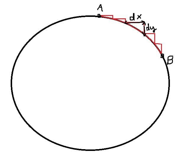

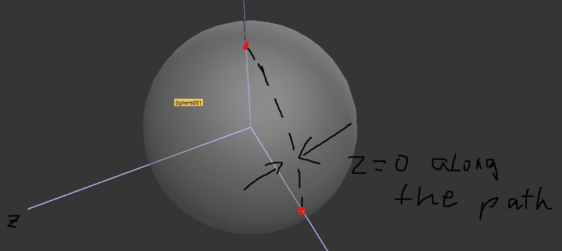

Trying to understand the meaning of this, I have tried the following:
Suppose we want to calculate the distance between two points on a sphere, where one point is on the pole and the other is on the equator of the sphere. We can set our coordinate axes such that one coordinate, say z, is always zero.
The infinitesimal Euclidean distance is ##ds^2 = dx^2 + dy^2##, but ##x^2 + y^2 = r^2## in this case, and so ##ds^2 = \frac{x^2}{y^2}dx^2 + \frac{y^2}{x^2}dy^2##. (Is this right?) It seems clear that the metric will have first, second, etc... derivatives. Now it seems that that space (surface of the sphere) has a curvature, although I have not worked on the components of the Riemann tensor. (There will be any non-zero component?)
This picture makes no sense as a way to assign coordinates to the two-dimensional surface of the sphere because there are points on all three coordinate axes that do not lie on the surface of the sphere - so whatever set of points are being labeled by those coordinates, it's not the set of points that corresponds to the surface of the sphere. Furthermore, you have three coordinates not two - taking ##z=0## reduces the number of coordinates by one, but the surface that is being described by the two remaining coordinates is not the surface of the sphere, it's a plane that intersects the sphere.
One way or another you need two coordinates, not three, that cover the surface of the sphere without picking up any points outside the sphere (informally, this means that the coordinate axes lie on the surface of the sphere). Latitude and longitude would work, as would stereographic coordinates. You can calculate the value of the components of the metric tensor for the surface of the sphere in your chosen coordinate system by using the concept that @Orodruin mentioned above: it's an induced metric once you've decide to think of the two-dimensional sphere as something embedded in Euclidean three-dimension space.
