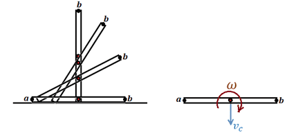

Consider releasing an upright coin from a smooth, frictionless surface. The coin has a radius of 0.01 m and falls sideways. Calculate the tangential velocity of the top of the coin just before the top of the coin hits the surface. You can treat the coin as a uniform disk.

Let ##b## be the top point. Just as the coin reaches the horizontal postition, what is the velocity of point ##a##? Use this fact to deduce ##\omega## in terms of ##v_c## at this instant. Then think about the velocity of ##b## in terms of ##v_c##.

sorry I am having a hard time understanding the first part of your sentence. isn't the velocity of point a the tangential velocity? which is the same for both a and b.
It depends whether you think of the coin's motion as the sum of a linearly downward motion and a rotation about its centre, or as just a rotation about its instantaneous centre of rotation (which would be point a).

Relative to the center of mass, points ##a## and ##b## move in circular motion and have the same tangential speed ##\omega r##. But, relative to the laboratory reference frame, the two points have different speeds. In fact, can you see that point ##a## is essentially at rest relative to the surface just before the coin strikes the surface?

Let ##\vec v_a## and ##\vec v_c## be the velocity of ##a## and the velocity of the center of mass, ##c##, relative to the laboratory. Let ##\vec v_{a/c}## be the velocity of ##a## relative to the center of mass. Using the concept of relative velocity we have, $$\vec v_a = \vec v_c + \vec v_{a/c}$$
Does either ##\vec v_c## or ##\vec v_{a/c}## have a non-zero horizontal component just before the coin strikes the table?
no
wcjy said:
no
Ok. So, the relative velocity formula ##\vec v_a = \vec v_c + \vec v_{a/c}## implies that point ##a## has zero horizontal velocity just before the coin strikes the table. Also, since point ##a## stays on the surface, it never has a vertical component of velocity.

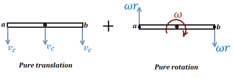

Since ##\vec v_a = 0## just before the coin strikes the table, the relative velocity formula implies that ##\vec v_c + \vec v_{a/c} = 0## at this instant. This will tell you how ##\omega## is related to ##v_c## if you can see how to express ##v_{a/c}## in terms of ##\omega## and ##r##.

the way i see it is that if the velocity of a is supposed to be rw, then for it to seem like it is '0' from the center, then Va/c should be = -rw.
this is probably wrong. but this is how i see it. i think my understanding of relative velocity is still not there
Pictorially, you can think of the motion of the coin as a combination of pure translation plus pure rotation about the center of mass. Just before the coin strikes the surface, the picture would be as shown below
The net velocity of point ##a## is ##v_c## downward plus ##\omega r## upward. These must combine to give zero net velocity for point ##a##.
