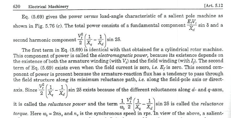

I was looking around and found this equation for salient pole machines:
[itex]P = \frac{E_f V_t}{X_d + X}sin\delta + \frac{V_t^2}{2}(\frac{1}{X_q+X}-\frac{1}{X_d+X})sin2\delta[/itex], If [itex]E_f[/itex] becomes zero, we still have this term: [itex]\frac{V_t^2}{2}(\frac{1}{X_q+X}-\frac{1}{X_d+X})sin2\delta[/itex], but [itex]X_d[/itex] is always less than [itex]X_q[/itex] i suppose? If that is the case, it will just work as a motor, right?

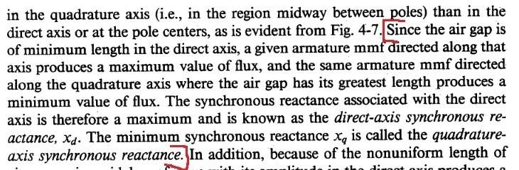

OliskaP said:
but XdX_d is always less than XqX_q i suppose?
Intuitively that sounds backward to me.
Air gap is largest between the salient poles so quadrature X is much smaller than direct

i'd have to see what is every term in that equation before i accepted it
is the sin2δ term reluctance torque ?

I found the equation mentioned above, referred to as "Eq. (5.69)" in the text below. It's derived from the same phasor diagram shown in the PDF document you linked in figure 4-41, just note that [itex]r_a[/itex] is assumed to be negligible.
Aha so i guessed right, that term is reluctance torque which exists because of the gap between field poles.

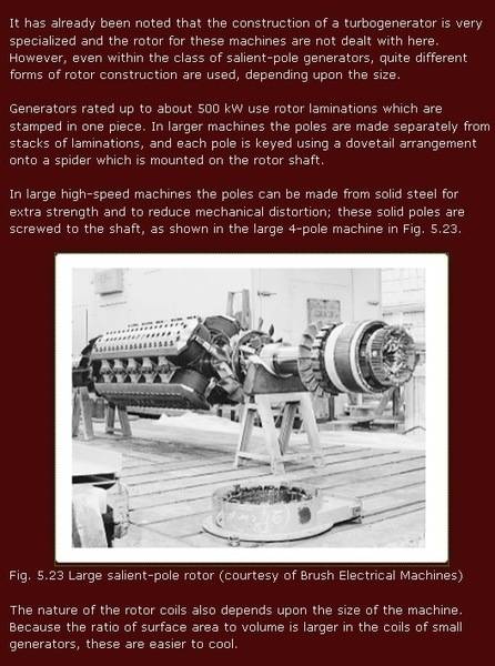

Wow look at all the bolts on this salient rotor !
Copy and paste it into Paint and expand..
http://emadrlc.blogspot.com/2012_11_01_archive.html
How many square inches of shiny bolt hold those pole pieces to shaft ?
I'm no mechanical engineer
but it looks to me like they gusseted it to turn some of the tension from radial to circumferential , is "hoop stress" the proper ME term ?
Here's another link
http://electricalengineeringdesigns.blogspot.com/2012/07/generator-rotor-construction-basic.html
I never saw anything like that. Ours were all machined from a solid cylinder which i believe is more typical.
