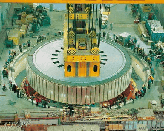

If you want to make 60 Hz power (or 50 Hz), with a low speed generator, it takes many, many poles. The construction of so many poles on a round rotor would be very difficult to get enough turns on each pole. Look at a round rotor and see how the turns are laid into the surface of the rotor. Commercial generators almost always use 3600 rpm (or 3000 rpm) with a two pole rotor. Now imagine trying to wind perhaps 20 poles on a round rotor.

Back to basics:
Voltage is in proportion to relative velocity between the conductor and the magnetic field.
In a slow turning water turbine it takes huge diameter to get much velocity.
I think you'd rather assemble this from separate pieces than machine it out of a solid forging.
see also https://www.gepowerconversion.com/sites/gepc/files/product/Hydro%20Generator%20Brochure.pdf
Likes LagCompensator, Dr.D and Bavuka
Thanks, it makes sense. So basically a cylindrical rotor would be preferred in all cases due to uniform airgap, and hence reduce distortion in the airgap flux? However due to the slow operating speed of i.e. hydro plants we need to use salient rotors, because we would require a lot of poles to get our 50/60Hz waveforms, something that would would not be feasible on a cylindrical rotor.
Likes jim hardy
Just a small aside here. If we look at the picture Old Jim posted, it is evident that the air gap variation is only a couple of inches or so. Much more extreme variations occur in the salient 4-pole alternators often used with diesel engines for standby power. In that case, four separate pole pieces are usually bolted to a much smaller center piece, with rather large gaps between the pole faces. The air gap variation is often quite large, and yet, these alternators work very well.
