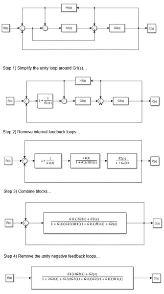

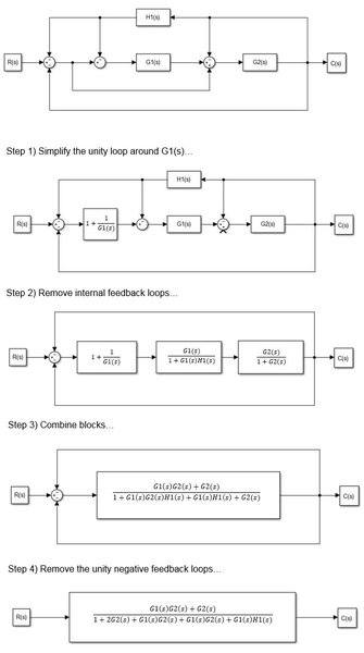

Simplify the block diagram. I uploaded a single image as it's the easiest way to do this problem.
None at this stage.
Please see the image.
None at this stage.
The posted image is virtually unreadable.
I agree.
While we generally discourage images in posts, in this case an image is very helpful.
Please post an image that is large enough so that we can read it.
This is approaches being readable. Use the Image icon in blue banner just a text box used to make a post.
