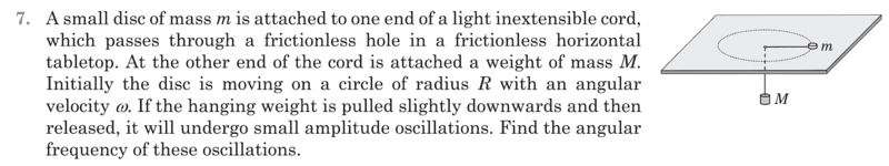

refer to image
refer to image
Writing force equations for block ##m## : $$T-mr\omega^2=m\ddot{r}$$ and for block ##M## : $$Mg-T=M\ddot{r}$$ I think there are mistakes in my equations as they are leading to nowhere and morever i think force methods are really risky in this regard . It would be better to write the total energy of the system which i don't know how to . I tried to write $$\frac{1}{2}m\dot{r}^2 +\frac{1}{2}M\dot{r}^2 + \frac{L^2}{2mr^2} +U(r)=E$$ where ##L=mR^2\omega##

Bling Fizikst said:
No
It should come out from conservation of AM and energy. You're aiming for an equation for ##\ddot r##. Which you should be able to get from:
... differentiating the energy equation should work.

I did that but how do i deal with the potential energy of the system : ##U(r)## $$(m+M)\ddot{r}-\frac{L^2}{mr^3}+U'(r)=0$$

What precisely is stopping you from writing down an expression for ##U(r)##?

How does the position of the mass M depend on ##r##? Take ##r = R## as the zero point.
Is it -Mgr:nb)

What happens to ##M## as ##r## increases?
it goes up so +Mgr? please forgive me if i am acting dumb , this is my first time using the potential energy function in this way . It gives me the wrong ans anyways , so it is wrong

Yes. Note that ##Mg## is related to ##L## by the initial equilibrium.
$$(m+M)\ddot{r} -mr\omega^2- 2mr\omega^2=0$$ $$\implies \omega'=\sqrt{\frac{3m\omega^2}{m+M}}$$
That's the right answer, but I'm not sure quite how you got there.

I wonder whether you replaced ##L^2## with ##mr^2w## here? To get from the above equation to this:
In any case, the solution only applies to small oscillations. You will need an approximation somewhere.
Yes
Note that ##w## is a constant, like ##M, g## and ##R## and is the fixed angular velocity at the equilibrium. ##r## and ##\dot \theta## are the variables. We have:
$$L = mR^2w = mr^2\dot \theta$$Also, with ##U(r) = Mgr##, we have:
$$\frac d{dt} U(r) = Mg\dot r$$And
$$\frac d {dt}\dot r^2 = 2\dot r \ddot r$$

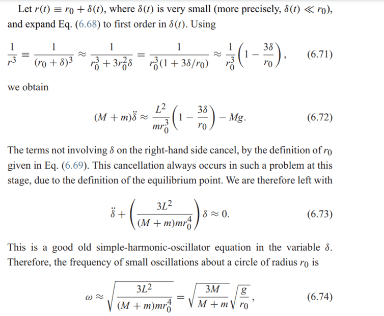

Anyways , i found a really elegant solution in David Morin :
Bling Fizikst said:
Anyways , i found a really elegant solution in David Morin : View attachment 342284

This was a new learning experience for me , so i don't really mind . But i do agree that one should try to solve problems on their own . At the end , it just matters that i learnt to solve it even if i had to look at the solution.
I just learnt a new technique and i am happy!
Also , i would love to thank you for patiently helping me throughout the problem 😇
