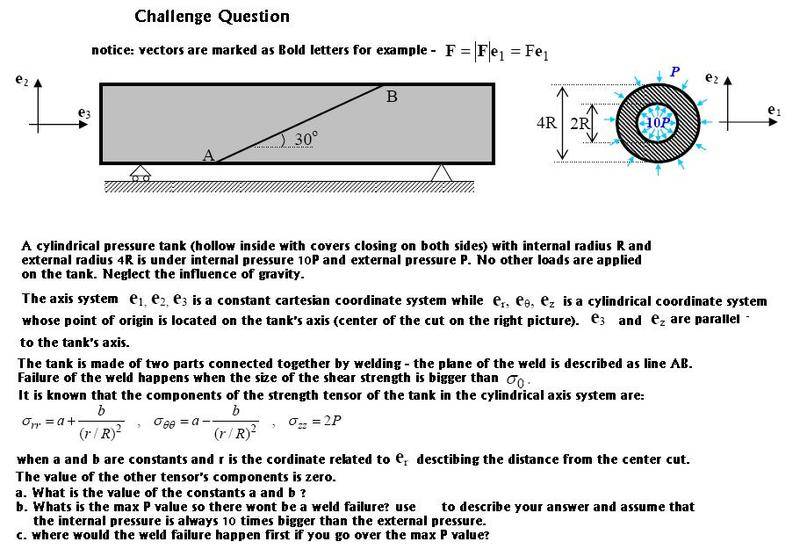

Here is the Question:
This question is given as a challenge extra credit task, and is a part of a course called solid mechanics 2 that deals more with shear strain and strain matrices.
While trying to translate the question I used the term "strength" instead of "strain" by mistake :)
I don't really have a lead how to begin, I would really appreciate if someone could guide me or write me some guidelines on how to find the constants and the max pressure
Thanks in advance and a good day to all :shy:
Can you relate the stress tensor components to the known pressure on the inside and the outside of the tank? Can you also relate these components to the shear stress on the weld?
I know that the stress tensor components for a cylinder under internal pressure 10P are:
[tex]\sigma_{rr}=-10P,\sigma_{\theta\theta}=\frac{10PR}{R},\sigma_{zz}=\frac{10PR}{2R}[/tex]
but I am confused as to how to refer to the external pressure?

Isn't the outside pressure P? What happens when you plug those two boundary conditions into [itex]\sigma_\mathrm{rr}[/itex]?
I agree with the transformation strategy to find the shear stress along with weld.
I just get -9P (by the way am i right about the minus sign)? and the outside pressure dosent affect the other components?
What do you get for a and b when you plug in a compressive stress of P when r corresponds to the outer surface, and a compressive stress of 10P when r corresponds to the inner surface?
you mean
while r<R (inner surface):
[tex]\sigma_{\theta\theta}=10P=a-\frac{b}{r/R^{2}},\sigma_{rr}=-10P=a+\frac{b}{r/R^{2}}[/tex]

it all seems a bit odd because the formulas for the stress tensor components relay on a Thin-Walled Pressure Vessel and here its not that thin because t=R. We usually get that [tex]\sigma_{rr}<<\sigma_{\theta\theta[/tex] but not here so are the formulas still valid?
I'm not sure why you're using [itex]\sigma_{\theta\theta}[/itex]; the pressures act radially. Also, a and b are the same constants throughout the problem.
These equations don't rely on the thin-wall assumption; if that were the case, the stresses would be constant.

a=3P, b=-13P or am i wrong about the signs of the pressures (+ / -) ?
[itex]\sigma_\mathrm{rr}=10P[/itex] is saying that the material is under tensile stress on the inner surface. This doesn't make much sense.
yeah i fixed that when i wrote the equation a+b=-10P and forget to correct it at the beginning. so these are the constants?

In your question, what is called external radius = 4R is at variance with the figure, where 4R is the external diameter

So in a cylindrical coordinate system i get:
[tex]\sigma=\begin{pmatrix}
3P-\frac{-13P}{(r/R)^{2}} & 0 & 0 \\
0 & 3P+\frac{-13P}{(r/R)^{2}} & 0 \\
0 & 0 & 2P \end{pmatrix}[/tex]
Given that my matrix is correct I'm going to save some time and start working on the transformation. Now since we are currently looking at a cylindrical coordinate system I think need to translate it to a cartesian system in order to move it by 30 degrees so:
[tex]x=r\cdot cos(\theta), y=r\cdot sin(\theta)[/tex] but I am unsure on how to apply the conversion in a tensor. Is the following conversion correct?

I'm still not seeing how you're setting the stress at the outer surface to be a positive value P, which represents a tensile stress. The outer surface is under compression.
Once you get this straightened out, try expressing the wall stress in terms of the rectangular coordinate system, apply the transformation, and check whether your answer makes sense.
But I did set it as possitive on the outside, its written in the second equation here below when r=2R:

This gives [itex]\sigma_\mathrm{rr}=P[/itex] at [itex]r=2R[/itex], but [itex]\sigma_\mathrm{rr}=-P[/itex] there (a compressive load).
After this is cleared up, you can write the stress tensor in terms of the [itex]\bold{e_1}[/itex], [itex]\bold{e_2}[/itex], [itex]\bold{e_3}[/itex] coordinate system and perform the stress transformation.
you mean the pressures are -10p and -p? then i get that a=2p, b=-12p and hopefully that's it for these two equations :)

(1) Check the [itex]\sigma_\mathrm{rr}[/itex] and [itex]\sigma_{\theta\theta}[/itex] values in your first matrix.
(2) Check which axis you're rotating around. The stress value for that axis will be unchanged after the stress transformation.

The trick here is to pick one angle on the structure, look at which directions the cylindrical axes point, and match these up to the rectangular axes. For example, let's work with the point midway between A and B. The radial axis [itex]\bold{r}[/itex] is collinear with [itex]\bold{e_1}[/itex], so [itex]\sigma_\mathrm{rr}=\sigma_{11}[/itex] at this point. Does this make sense?
  • #34
yes. and e_3=e_z but what about e_2? you can also say that its the same direction as r on two locations..
  • #35
So let's only work with a single point. (Any point along the weld is equivalent, right?)
