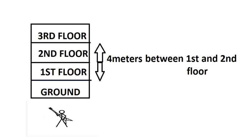

Let's say we have a 3 floor/level building , and someone is making noise outside, i.e: Playing guitar, given that all the building has the same sound isolation everywhere, what can you say about the sound propagation? we have 2 cases a) when windows opened b) when windows closed
Will the people living on 1st floor will be more affected by sound(will they hear it more intense), compared with the people living on 2nd floor, will there be any difference in terms of noise?

My question was , given that we have a building in open air , isolated everywhere same , and an outside noise occurring, where will the noise have the biggest impact
a) 1st floor
b)2nd floor which is 4 m above 1st floor
c) it won t be any difference in noise

The distance from the building let's say about 3-4 meters , temperature constant at like 20 degrees Celsius, building not surrounded by anything, but has same phonic isolation everywhere.
I think that there won't be any difference in noise between the 2 floors, so if someone is having a party on the ground floor, the 1st and 2nd floors will hear the same noise(no difference in the noise intensity between the 2 floors that are 4 m apart in height.)

Now you confused me, so you are saying the people on the first floor will be more affected than those on the 2nd floor?
I just want a detailed answer: If someone is having a party on the ground floor 10 meters away from the building, is it true that the people on 2nd floor will be less affected due to the greater thickness that the sound needs to go through?(2 levels of thickness) compared with 1?
How is it correct with regards to the noise(1st floor vs 2nd floor) ? What is the correct answer and why?

that's incorrect the more floors/ceilings the sound travels through the more attenuated the sound will get
anyway, that is a different issue compared to an outside sound
Ignoring minor air pressure/temperature differences with height, and the building insulating being constant, there is
only one that that will affect the sound level ( assuming an Omni-direction sound source)
have you figured out what that is yet ?

So the sound comes from outside the building, and it will get atenuated until it reaches 2nd floor right, I mean the people inside the building on the 2nd floor will hear less noise than those on the 1st floor right?But how exactly, and why? There are 4 meters between the 2 floors.
I can think just about temperature/pressure difference between the 2 floors, and obviously the height.

as I said, the temp/press differences over that height are minor and not worth worrying about
what factor specifically does height play in it
if it is higher it is ___________ from the source, therefore the sound is more ___________
you fill in the blanks

If it is higher is has a greater distance from the source, therefore the sound/noise is less.
But is it such a big difference given that there is 4m between the 2 floors?

YES and it is more attenuated
naaa, by ear probably not noticeable ... but may be measured with sensitive sound meter
if you were to compare over a much further distance ... 10, 20 floors or more then you would start hearing a signif difference

Can you be sure of that? The temperature near the ground can be several degrees higher than at a few metres (hot ground after a day's sun). That could have the effect of tilting the waves upwards. This would only apply significantly for a distant sound source.
However, if the sound source is in the middle distance that is proposed by the OP, we are in the most difficult situation for any rough calculation.
The OP can easily draw a diagram with the distances he has specified and (Pythagoras) work out the difference in distances to the two floors. Using the inverse square law (crude, I know) he can work out the relative 'spreading loss' from source to the two windows. This effect will be less and less as the source moves away.
