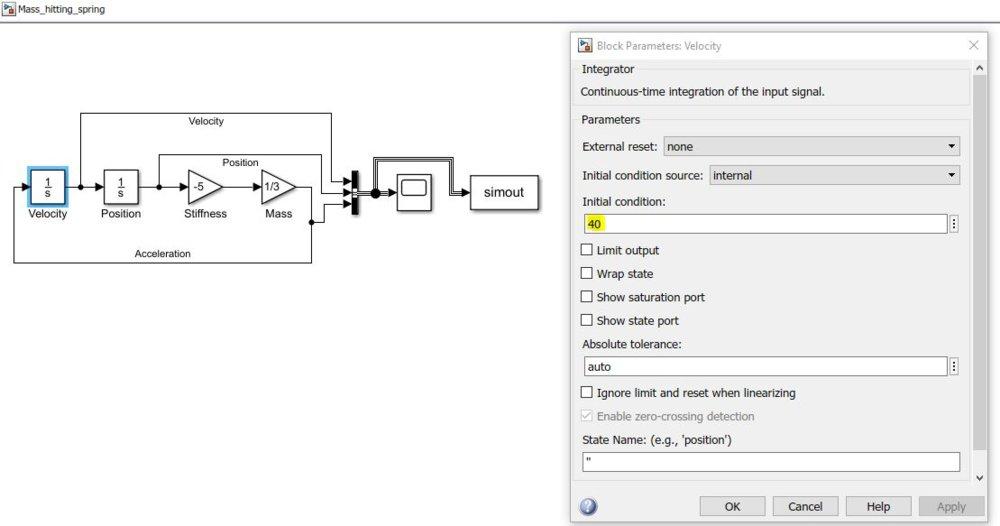

I don't know much about Simulink but I assume you are implementing differential equations and the software takes care of evolving a solution numerically from starting conditions. So here's a more convenient form for that.
A common transformation of 2nd order equations is to turn it into a system of 1st order equations.
So we have this:
$$-kx = m\frac {d^2x}{dt^2}$$
Change it to this equivalent system in the two variables ##v## and ##x##:
$$\frac {dx}{dt} = v \\
m\frac {dv}{dt} = -kx$$
Implement those two equations in those two unknowns with the desired initial conditions on ##x## and ##v##.

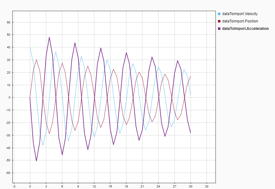

@RPinPA - I tried this in Simulink and there is actually a progress:
245203
However, I see some form of dampening effect in all position, velocity and acceleration plots. I am unable to understand the reason for this. This is my simulink model:
245204
The initial condition (40) tells that dx/dt = 40 when t = 0. I am not very sure if this way of inputting is right. I will be so glad if someone of PF helped me out of this issue. Thank you for guiding me very closely.
