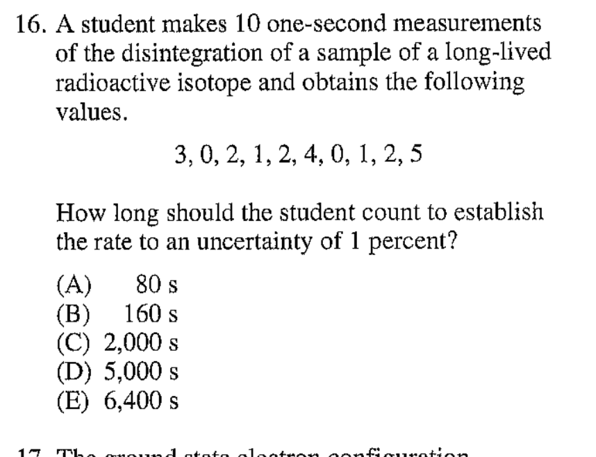

In summary, to determine the uncertainty on the rate from a measurement of 100 counts in 7 seconds, you will need to use a larger number of counts to achieve a lower uncertainty. The goal is to get to an uncertainty of 1% or less. A rough estimate of the decay rate can be obtained using the existing measurements to determine the time needed to accumulate 10000 counts.
Same as in the other thread, you'll have to show what you did so far.
I extended the title to be more descriptive of the problem statement.

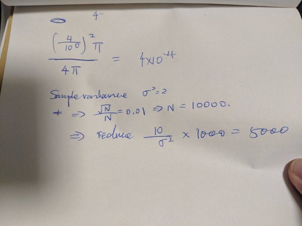

If you have a measurement, e.g. 100 counts in 7 seconds, what will your uncertainty on the rate be?
10 since since sigma is sqrt of N so I set sqrtN/N=0.1 but that didn't get me very far
These problems take longer than a second to solve. Why don't you write down your strategy for solving this. In words.
Well, that is an important step already. An uncertainty of 10 is an uncertainty of 10% here. Too much, you'll need more counts to get to 1%...
I'm good thanks
Sorry it's supposed to be 0.01 but it still won't make sense because 10,000 counts represents 1000s measurement.
My desperate attempt whcih matches the answer
10000 counts is correct. You can use the existing measurements to get a rough estimate of the decay rate and use that to get the time you need to accumulate 10000 counts.
