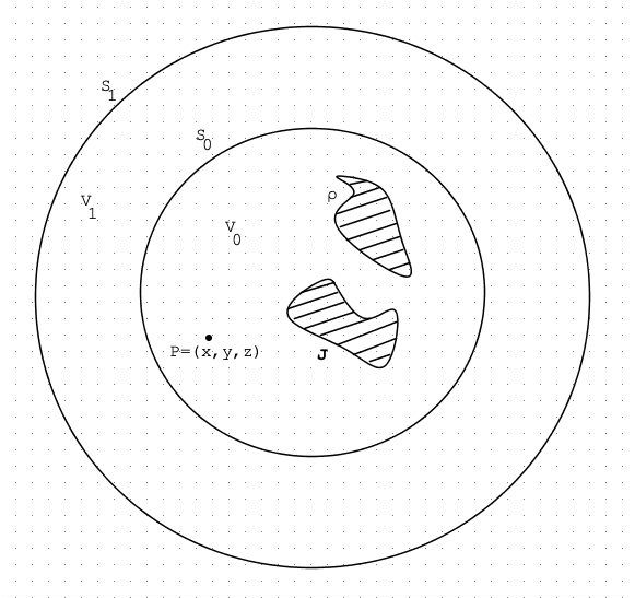

Next step. Let's consider a new surface, bigger than ##S_0##, call it ##S_1##:
with the same reasoning, we can conclude that in every point (x,y,z) in the interior of ##S_1##, that is, in ##V_1\supset V_0##, the following formula holds:
$$\mathbf{E}_1(\mathbf{r})=\frac{1}{4\pi}\int_{V_1}\left(\frac{\rho(\mathbf{r}')}{\epsilon_0}\nabla'\psi(\mathbf{r},\mathbf{r}')-j\omega\psi(\mathbf{r},\mathbf{r}')\frac{\mathbf{J}(\mathbf{r}')}{\mu_0^{-1}}\right) \mathrm{d}V'+$$
$$+\frac{1}{4\pi}\int _{S_1} \left[ j\omega \left ( -\mathbf{1}_n\times\mathbf{B}(\mathbf{r}')+\frac{\mathbf{E}(\mathbf{r}')}{c} \right )+ \frac{\mathbf{E}(\mathbf{r}')}{R(\mathbf{r},\mathbf{r}')}\right ] \frac{e^{-jkR(\mathbf{r},\mathbf{r}')}}{R(\mathbf{r},\mathbf{r}')}\mathrm{d}S'\quad (1)$$
and the field, knowing its value on the surface ##S_1## is unique in ##V_1##.

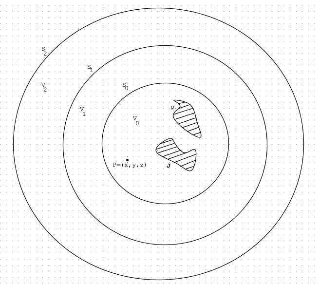

Take a new surface, do the same thing:
$$\mathbf{E}_2(\mathbf{r})=\frac{1}{4\pi}\int_{V_0}\left(\frac{\rho(\mathbf{r}')}{\epsilon_0}\nabla'\psi(\mathbf{r},\mathbf{r}')-j\omega\psi(\mathbf{r},\mathbf{r}')\frac{\mathbf{J}(\mathbf{r}')}{\mu_0^{-1}}\right) \mathrm{d}V'+$$
$$+\frac{1}{4\pi}\int _{S_2} \left[ j\omega \left ( -\mathbf{1}_n\times\mathbf{B}(\mathbf{r}')+\frac{\mathbf{E}(\mathbf{r}')}{c} \right )+ \frac{\mathbf{E}(\mathbf{r}')}{R(\mathbf{r},\mathbf{r}')}\right ] \frac{e^{-jkR(\mathbf{r},\mathbf{r}')}}{R(\mathbf{r},\mathbf{r}')}\mathrm{d}S'\quad (2)$$
and rewrite (1) as:
$$\mathbf{E}_1(\mathbf{r})=\frac{1}{4\pi}\int_{V_0}\left(\frac{\rho(\mathbf{r}')}{\epsilon_0}\nabla'\psi(\mathbf{r},\mathbf{r}')-j\omega\psi(\mathbf{r},\mathbf{r}')\frac{\mathbf{J}(\mathbf{r}')}{\mu_0^{-1}}\right) \mathrm{d}V'+$$
$$+\frac{1}{4\pi}\int _{S_1} \left[ j\omega \left ( -\mathbf{1}_n\times\mathbf{B}_2(\mathbf{r}')+\frac{\mathbf{E}_2(\mathbf{r}')}{c} \right )+ \frac{\mathbf{E}_2(\mathbf{r}')}{R(\mathbf{r},\mathbf{r}')}\right ] \frac{e^{-jkR(\mathbf{r},\mathbf{r}')}}{R(\mathbf{r},\mathbf{r}')}\mathrm{d}S'\quad (1)$$
Then ##\mathbf{E}_2(\mathbf{r})=\mathbf{E}_1(\mathbf{r})## for every (x,y,z) in ##V_1## and also ##\mathbf{E}_2(\mathbf{r})=\mathbf{E}_1(\mathbf{r})=\mathbf{E}_0(\mathbf{r})## for every (x,y,z) in ##V_0##.Doing this thing n times, we have:
$$\mathbf{E}_n(\mathbf{r})=\frac{1}{4\pi}\int_{V_0}\left(\frac{\rho(\mathbf{r}')}{\epsilon_0}\nabla'\psi(\mathbf{r},\mathbf{r}')-j\omega\psi(\mathbf{r},\mathbf{r}')\frac{\mathbf{J}(\mathbf{r}')}{\mu_0^{-1}}\right) \mathrm{d}V'+$$
$$+\frac{1}{4\pi}\int _{S_n} \left[ j\omega \left ( -\mathbf{1}_n\times\mathbf{B}_{n+1}(\mathbf{r}')+\frac{\mathbf{E}_{n+1}(\mathbf{r}')}{c} \right )+ \frac{\mathbf{E}_{n+1}(\mathbf{r}')}{R(\mathbf{r},\mathbf{r}')}\right ] \frac{e^{-jkR(\mathbf{r},\mathbf{r}')}}{R(\mathbf{r},\mathbf{r}')}\mathrm{d}S'\quad (n)$$
where:
##\mathbf{E}_n(\mathbf{r})=\mathbf{E}_{n-1}(\mathbf{r}), \quad \forall \mathbf{r}\in V_{n-1}##,
##\mathbf{E}_n(\mathbf{r})=\mathbf{E}_{n-1}(\mathbf{r})=\mathbf{E}_{n-2}(\mathbf{r}), \quad \forall \mathbf{r}\in V_{n-2}##,
##\mathbf{E}_n(\mathbf{r})=\mathbf{E}_{n-1}(\mathbf{r})=...=\mathbf{E}_{0}(\mathbf{r}), \quad \forall \mathbf{r}\in V_{0}##.
Now, let's take (x,y,z) inside an arbitrary choosen ##S_k##, with ##k<n##. Formula (n) is valid to evaluate the field in every point of ##V_k##. So, the field in every point of ##V_k## is indifferent to which formula (n) (with n>k) I will use to calculate it.
In particular, bringing ##n## to infinity we have:
$$\mathbf{E}(\mathbf{r})|_{\mathbf{r}\in V_k}=\lim_{n\to\infty}\mathbf{E}_n(\mathbf{r})|_{\mathbf{r}\in V_k}=\frac{1}{4\pi}\int_{V_0}\left(\frac{\rho(\mathbf{r}')}{\epsilon_0}\nabla'\psi(\mathbf{r},\mathbf{r}')-j\omega\psi(\mathbf{r},\mathbf{r}')\frac{\mathbf{J}(\mathbf{r}')}{\mu_0^{-1}}\right) \mathrm{d}V'+$$
$$+\lim_{n\to\infty}\frac{1}{4\pi}\int _{S_n} \left[ j\omega \left ( -\mathbf{1}_n\times\mathbf{B}_{n+1}(\mathbf{r}')+\frac{\mathbf{E}_{n+1}(\mathbf{r}')}{c} \right )+ \frac{\mathbf{E}_{n+1}(\mathbf{r}')}{R(\mathbf{r},\mathbf{r}')}\right ] \frac{e^{-jkR(\mathbf{r},\mathbf{r}')}}{R(\mathbf{r},\mathbf{r}')}\mathrm{d}S'$$
The last quantity is, by hypothesis that the field satisfies Sommerfeld conditions, null. So we have
$$\mathbf{E}(\mathbf{r})|_{\mathbf{r}\in V_k}=\frac{1}{4\pi}\int_{V_0}\left(\frac{\rho(\mathbf{r}')}{\epsilon_0}\nabla'\psi(\mathbf{r},\mathbf{r}')-j\omega\psi(\mathbf{r},\mathbf{r}')\frac{\mathbf{J}(\mathbf{r}')}{\mu_0^{-1}}\right) \mathrm{d}V'$$
Comparing this formula with the formula (k), we must have:
$$\int _{S_k} \left[ j\omega \left ( -\mathbf{1}_n\times\mathbf{B}_{k+1}(\mathbf{r}')+\frac{\mathbf{E}_{k+1}(\mathbf{r}')}{c} \right )+ \frac{\mathbf{E}_{k+1}(\mathbf{r}')}{R(\mathbf{r},\mathbf{r}')}\right ] \frac{e^{-jkR(\mathbf{r},\mathbf{r}')}}{R(\mathbf{r},\mathbf{r}')}\mathrm{d}S'=\mathbf{0}$$
Do you agree so far?
It seems to me that the reasoning is now crystal clear.
Yes, as I have said. Mystery solved. I make the following 3 observations.
1) The last identity which you derived in #19 is valid, but only as an integral relation.
2) Your original conclusion in #1 that the integrand vanishes point wise is clearly wrong in general.
3) In the extreme far field the integrand does vanish point wise but only in an asymptotic sense.
3.01) Oh, after skimming your post #19 more carefully your "limiting" argument seems kind of silly. Just use 2 points, one in the near field at ##S_o## and the other in the extreme far field, ##S_\infty##. Then subtract the resulting expressions. Observe that ##S_\infty## vanishes asymptotically. Conclude the last expression in #19 holds at ##S_o##.
Okay, some additional comments are needed. ##E_0(x,y,z)## is just ##E(x,y,z)## the field at a point. Equation (0) is an integral identity. The field at this point doesn't care where your integrations are performed provided the evaluation point is interior to the region. For the volume integrals it's important to realize the integrands are only non-zero where the sources are non-zero. Making a bigger surrounding sphere doesn't change the volume integrals at all.
In fact, this is exactly what I used in #19.
Ok, wonderful.
Ok, right. Then, I think that rigorous mathematical way to view what happens in far fields is the following. Let's take as start point the last expression in #19, for ##S_0## for example, in the particular case in which ##S_0## is a sphere. Let's then write the surface integral in terms of solid angles:
$$\int _{4\pi} \left[ j\omega \left ( -\mathbf{1}_n\times\mathbf{B}_{1}(\mathbf{r}')+\frac{\mathbf{E}_{1}(\mathbf{r}')}{c} \right )+ \frac{\mathbf{E}_{1}(\mathbf{r}')}{R(\mathbf{r},\mathbf{r}')}\right ] \frac{e^{-jkR(\mathbf{r},\mathbf{r}')}}{R(\mathbf{r},\mathbf{r}')}R_0^2\mathrm{d}\Omega'=\mathbf{0}$$
We can take the limit ##R_0\to\infty## on both sides, and we can also note that the limit can pass the integral sign because it acts on a different variable:
$$\int _{4\pi} \lim_{R_0\to\infty}\left[ j\omega \left ( -\mathbf{1}_n\times\mathbf{B}_{1}(\mathbf{r}')+\frac{\mathbf{E}_{1}(\mathbf{r}')}{c} \right )+ \frac{\mathbf{E}_{1}(\mathbf{r}')}{R(\mathbf{r},\mathbf{r}')}\right ] \frac{e^{-jkR(\mathbf{r},\mathbf{r}')}}{R(\mathbf{r},\mathbf{r}')}R_0^2\mathrm{d}\Omega'=\mathbf{0}$$
Then we must have:
$$\lim_{R_0\to\infty}\left[ j\omega \left ( -\mathbf{1}_n\times\mathbf{B}_{1}(\mathbf{r}')+\frac{\mathbf{E}_{1}(\mathbf{r}')}{c} \right )+ \frac{\mathbf{E}_{1}(\mathbf{r}')}{R(\mathbf{r},\mathbf{r}')}\right ] \frac{e^{-jkR(\mathbf{r},\mathbf{r}')}}{R(\mathbf{r},\mathbf{r}')}R_0^2=\mathbf{0}$$
otherwise the integral would not be zero.
Now we note that:
$$R(\mathbf{r},\mathbf{r}')=\sqrt{(x-x')^2+(y-y')^2+(z-z')^2}=\sqrt{||\mathbf{r}-\mathbf{r}'||^2}=\sqrt{(\mathbf{r}-\mathbf{r}')\cdot (\mathbf{r}-\mathbf{r}')}=\sqrt{||\mathbf{r}'||^2+||\mathbf{r}||^2-2\mathbf{r}'\cdot \mathbf{r}}=||\mathbf{r}'||\sqrt{1+||\mathbf{r}||^2/||\mathbf{r}'||^2-2\mathbf{r}'\cdot \mathbf{r}/||\mathbf{r}'||^2}\underset{R_0\to\infty}{\sim} ||\mathbf{r}'||$$
because ##||\mathbf{r}'||=R_0## in the surface integral.
Turning back to the limit, and using this last fact, we obtain:
$$\left\{\begin{matrix}\lim_{R_0\to\infty}\left[ j\omega R_0\left ( -\mathbf{1}_n\times\mathbf{B}_{1}(\mathbf{r}')+\frac{\mathbf{E}_{1}(\mathbf{r}')}{c} \right )\right ] =\mathbf{0} \\ \lim_{R_0\to\infty}\mathbf{E}_{1}(\mathbf{r}')=\mathbf{0}\end{matrix}\right.$$
The first in particular can be equivalently written as:
$$j\omega \left( -\mathbf{1}_n\times\mathbf{B}_{1}(\mathbf{r}')+\frac{\mathbf{E}_{1}(\mathbf{r}')}{c}\right ) \underset{ R_0\to\infty }{=} o(1/R_0) $$
that is:
$$\mathbf{E}_{1}(\mathbf{r}')\underset{ R_0\to\infty }{\sim}c \left(\mathbf{1}_n\times\mathbf{B}_{1}(\mathbf{r}')\right)$$which is wonderfully beautiful and rigurous.
Thanks for letting me know where I was wrong.
