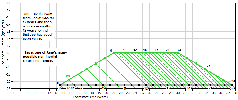

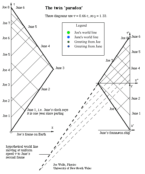

@ghwellsjr so are you saying that UNSW got it wrong?
Yes, that's what I said, wrong and ridiculous. Don't forget the ridiculous part.
I said their first diagram is close to being right but their second diagram is wrong.
If they had used their second diagram to show just the messages coming from Joe to Jane they would have made a diagram that was more like the one DrGreg made in post #39. Note that he is only showing the messages going from the inertial twin to the traveling twin. That part of the diagram, as I already stated, is fairly good.
But the part that is completely wrong is where they also try to show the messages going from Jane to Joe. If you look at their first diagram, you can see that Joe receives these messages at two different rates. The first three messages take over two years each for him to receive, then in his last year he receives all the rest of them. They show this pretty close to being right and it's important that a diagram show that the inertial twin receives half of the messages at a slow rate and half of the messages at a fast rate and it's important to show that the time interval over which he receives those message is not evenly spaced. He spends way more of his time receiving the low rate messages and only a short time near the end receiving the high rate messages.
It's also important that a diagram show that the traveling twin spends exactly half her time receiving the low rate messages during the outbound portion of her trip and the other half of her time receiving the high rate messages during the inbound portion of her trip. They do a good job of showing this aspect in both diagrams.
However, if you look at their second diagram, you see that Joe does not receive any messages until half way through the diagram at which point he receives all the messages from Jane equally spaced in time. It's the correct spacing in time for the last messages but not for the first three. It's faster than it should be. This is wrong and it's a ridiculous concept to try to show on a combined diagram like this. In fact, I have no idea how to correctly show Joe receiving the messages from Jane at the correct rates and to show the transmission of the signals traveling at c between the two twins. I'm not saying it can't be done, just that I don't know how to do it.
And again, I ask you, why do you feel compelled to combine portions of two perfectly good Inertial Reference Frames into one ridiculous monstrosity? Why not just show everything in each one of the Inertial Reference Frames like I did in post #67?

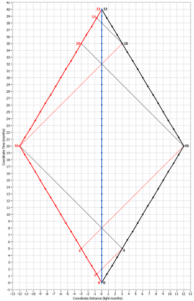

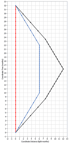

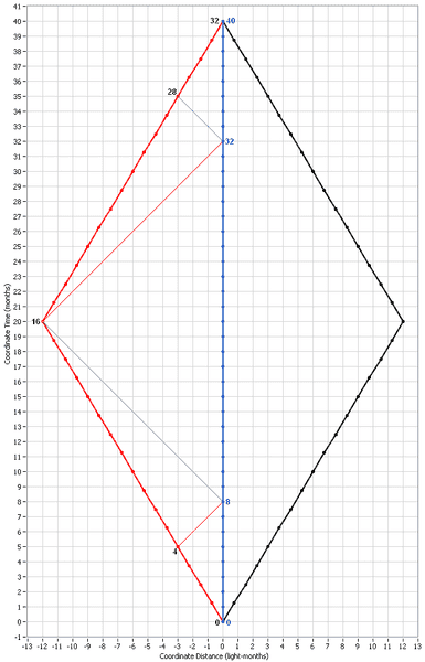

Just an attempt to visualize it from the space twin's perspective. Guess you could take it up with them Aussie bastards.

He can visualize that "ridiculous" diagram. Doesn't that explain the time gap objection, and also the visual description that you gave earlier on?
Another interesting fact is that if your three diagrams are transformed using Galilean methods, they produce something that looks somewhat similar to the "ridiculous" diagram.

Yes, it does explain the visual description that I gave earlier on but it's exactly the same visual description. I asked you "what more can the space twin visualize".
(Keep in mind, I only applied the term "ridiculous" to the part of the second diagram that is supposed to illustrate what Joe visualizes. I said they did a fairly good job of showing what Jane visualizes. With that in mind, let's continue.)

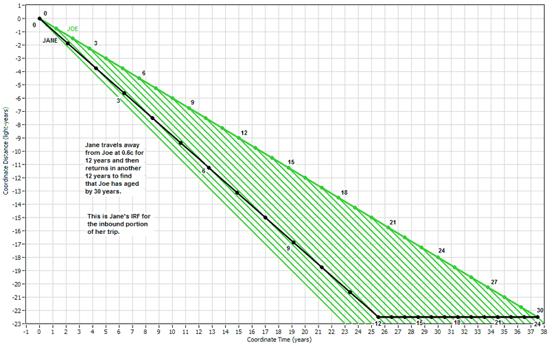

Look at the diagram from the website:
Look at the diagram on the left. You will see that Jane only sees one message from Joe during the outbound leg of her trip shortly after her second anniversary. Then during the inbound leg, she sees the remaining seven messages equally spaced in time.

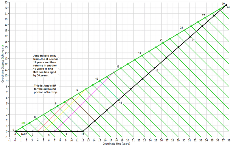

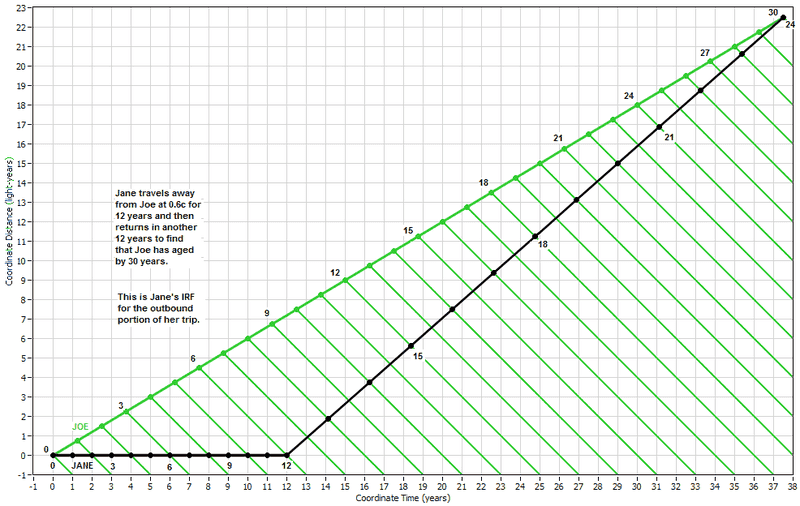

Now because the webpage does not show you complete IRF's I want to take you to my diagrams in post #67. The first one is virtually identical to theirs that we just looked at. But now look at my second diagram. During the outbound leg, Jane sees one message from Joe slightly after her second anniversary and then all the rest of them equally spaced during the return leg--exactly like in the first IRF. Same for the third diagram. And notice that none of these diagrams have any time gaps in them.

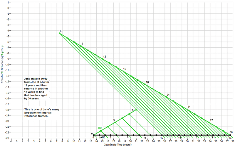

So now we get to the webpage's second diagram. They say in the text that this is the combination of two IRF's, the two that I show completely that we just considered. Now they chop up those two IRF's and combine them on one diagram and in the course of doing that, they introduce a time gap which they duly explain. But note that this time gap is not anything that Jane can see or visualize. I'm just asking the question, why create the problem in the first place?
It makes as much sense to me as if I took my first diagram and cut it in half horizontally at the turn-around point and then rotated each half so that Jane's path was in a straight vertical line. Then I would have introduced a huge triangular shaped gap which I would need to explain and if I succeeded in doing that, do I deserve extra credit? Does it have any bearing on what Jane visualizes? If you think so, please tell me what it is.
Are you interested in continuing the analysis to include the other triplet? If so, I need you to drop this issue of the combined IRF's. Are you willing to do that?

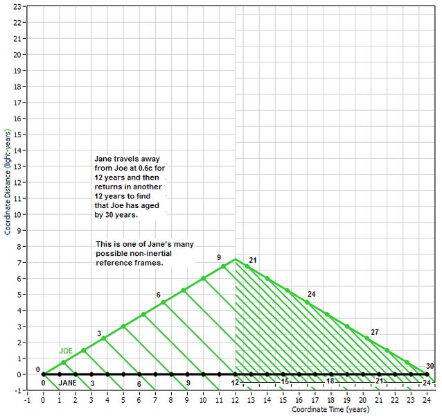

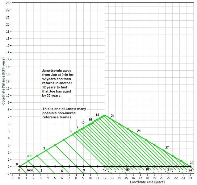

I think the time gap is something that Jane can visualize. And since it matches your visual description, it does have bearing on what she sees. For instance, if Jane backtracks she can find out that some photons popped out from nowhere.

I can certainly see why you believe this based on your third graph from post #30 and #37 buy you are the only one that believes this. You point me to a link in post #66 that you claim supports your graph but if you read the text, you will see that they go to great lengths to show that the Doppler explanation is correct and any idea that Jane sees anything differently because of an analysis based on jumping between her two inertial frames is wrong. Did you carefully read the text with regard to what Jane sees and experiences and concludes?
Furthermore, if you want to hang on to your chopped up graph for Adam and Charles, what are you going to do for a graph that also includes Bob?

Why is it wrong? Its a time gap after all. I pulled that diagram from UNSW.
There's nothing wrong with your Doppler explanation.
But I can't find the part where they say that any idea that Jane sees anything differently because of an analysis based on jumping between her two inertial frames is wrong (what a mouthful :cool:) , could you highlight it?
  • #81

The time gap is quite clearly illustrated in their diagram.
Joe doesn't notice the time gap because he is always in an IRF and from his point view Jane just ages slower due to time dilation. There is a time gap for Jane, because as mentioned in the passage, when she undergoes infinite acceleration, or switches frames:
The causes of this asymmetry are the fact that Jane reverses direction and Joe does not, and the finite time that light takes to transmit this information to Joe means that Joe doesn't get the news immediately. Jane leaves one inertial frame and joins another, and she has the effect of that change immediately. Joe, on the other hand, doesn't notice the effects of Jane being in a different inertial frame until much later because she is a long way away from him when it happens. The asymmetry is as simple as that.

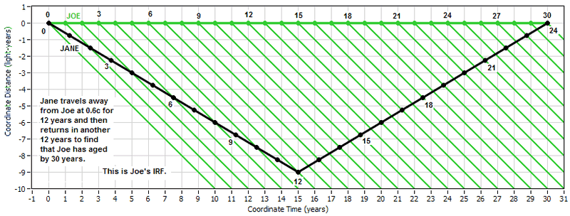

OK, good, we're making progress because back in post #23 when I presented exactly the same Doppler explanation that you just quoted from the webpage at the end of your previous post, you disagreed and thought I was brilliantly and cleverly making an incorrect argument.

They only tally for Jane. They don't tally for Joe. I explained this over and over again. Here, let's look at their two diagrams again (or you can look at their animation):
Focus on the diagonal lines going upwards to the left like this \. Do you see how in the first diagram, Joe receives the first three spaced far apart and the last three spaced much closer together? Do you see how in the second "married" diagram, Joe receives all six with exactly the same spacing? Both diagrams can't be right. The second "married" diagram does not tally for Joe and that is why I'm trying to get you to forget about "married" diagrams. They can only work in limited situations. Unmarried IRF diagrams work in all situations.

Yes, and only in their second diagram. Jane won't actually see any time gap with her eyes looking at her own clocks or looking into space at any remote clocks. Just because someone draws a diagram of an IRF like the first one or a "married" diagram like the second one will have no bearing on what she actually sees.
Again, this euphemistic terminology only means that she does not remain at rest in any IRF because she is not inertial. But it doesn't mean that we must analyze what happens to Jane or Joe or what each one can see by using only their rest frames. We can use any IRF we want, even one in which none of them is ever at rest. No IRF is preferred, not even an observer's rest IRF.
This quote is not an explanation of time dilation or of at time gap. As I said before, it is a description of the Doppler analysis that I presented to you back in post #23 and which you disagreed with in post #24 so I'm glad you are now firmly in agreement with the Doppler analysis.
I know this has been a long post but the crux of the issue is that you asked about a triplet scenario which I want to continue explaining but I cannot do it unless you are willing to accept that any single IRF is legitimate and adequate to explain everything and there is never a need to combine portions of two or more IRF's. If we can continue without regard to "married" IRF's and I can explain the triplet scenario in the same way that I explain the twin scenario, then maybe you can try to see how you would marry two or more IRF's to explain the triplet scenario.
Are you willing to concede that time dilation and time gaps appear only in diagrams and are not observable by any of the observers in any scenario?
Let's say Jane keeps time and she knows the relative velocity between her and Joe, thus she knows the distance between them.
Based on the Doppler analysis, Jane sees Joe's signals as pop-ups on her computer screen, telling her how old Joe is and all the cool stuff he did on his birthday like getting wasted.
Considering everything from her frame, be it inertial or not, and knowing that Joe's signals always approach at the speed of light, Jane can thereby conclude that she received signals that contradict with Joe's known positions. Sort of figuring out there's a time gap.

If you look back at post #65 at the top of page 5 you will see the third diagram showing Adam, in black, traveling at 0.6c away from Charles in blue for 12 months and then he turns around and returns in another 12 months to find that Charles has aged by 30 months. Please reread that post for background. I have redrawn the third diagram here with the axes in the more normal configuration for spacetime diagrams. They are not so wide this way. Note the monthly yellow signals sent by Charles and the monthly black signals sent by Adam:
Now if we focus on how Charles would actually measure the position of Adam as a function of time (as opposed to simply calculating his position based on his speed and the elapsed time), he would make use of the radar method. This works as follows. At some point in time, he sends a signal to Adam with the time the signal was sent. When Adam gets the signal, he sends a signal back, including the original time the signal was sent and the time on his clock when he sent the response. When Charles receives this signal, he takes the difference between the received time and the sent time and divides that by two and interprets that as a distance (because we are using c=1) and applies it to the midpoint (or the average) between the two times.
So let's see how that works on the diagram. At the first dot after Adam's departure, Charles sends a signal indicated by the yellow line which Adam receives at his clock time of 2. He sends the signal back to Charles who gets it at his time of 4. So Charles calculates (4-1)/2 = 1.5 light-months and applies that distance to the average of 1 and 4 which is 2.5 years. So we can see that at 2.5 years into the trip, Adam has traveled a distance of 1.5 light-months. (We can also verify that Adam's speed is 1.5/2.5 = 0.6c.) The "time gap" you spoke of is that Adam says that the time was 2 months when he received the signal from Charles and when he was 1.5 light-months away, not the 2.5 months that Charles calculates.
You can repeat this process for any point along the way of Charles's time line. It will correctly indicate the position of Adam, including the turn-around point and the trip back, according to Charles's IRF. I have made a list of all the points along Charles's time line that show signals going from Charles and with a response back from Adam. Each line shows a distance that Charles measures at the time it is applied:
0.00 @ 0.00
1.50 @ 2.50
3.00 @ 5.00
4.50 @ 7.50
6.00 @ 10.00
7.50 @ 12.50
9.00 @ 15.00
8.25 @ 16.25
7.50 @ 17.50
6.75 @ 18.75
6.00 @ 20.00
5.25 @ 21.25
4.50 @ 22.50
3.75 @ 23.75
3.00 @ 25.00
2.25 @ 26.25
1.50 @ 27.50
0.75 @ 28.75
0.00 @ 30.00
And you can repeat this process for Adam sending a similar signal to Charles and getting a response back from Charles. The situation between them is symmetrical, at least for the first four measurements (counting the one at zero) and they both see the other one as having a "time gap". However, the above diagram does not support Adam's measurements because he is not at rest in it. For that, we need to transform all the events in IRF displayed in the above diagram to an IRF moving at 0.6c to show Adam at rest. Here is the diagram depicting Adam's IRF for the outbound portion of his trip:

Here is the diagram that correctly shows the measurements that Adam makes of Charles's distance and in which Adam is always at rest. Note that this is for a non-inertial reference frame but it does correctly show the propagation of all the signals (something which I had previously claimed would be impossible, such as in post #67):
Now this is a very satisfying composite diagram that takes portions from the two IRF's in which Adam is at rest and then fills in the details that covers the "time gap" that is apparent in other "marriages" of the two IRF's but without any time gap. Everything is as smooth as it is in any IRF. I like it, I hope you do too.
It might be helpful to understand how I arrived at this type of diagram. I was trying to see how to combine two "married" IRF's for a different scenario. Here is the first of those two diagrams:
Note that the above diagram showing the signals going from the home twin to the traveling twin is similar to the one that Dr Greg provided in post #39 of this thread.
And here is the other one that shows the signals going from the traveling twin to the home twin:
I printed both these diagrams out and laid the printouts one on top of the other and held them up to the light so I could see through both of them. I aligned the rest positions of the traveling twin and then marked the intersections of the blue and black signals that matched the "path" of the home twin on a normal IRF diagram. I was surprised to see that they formed a straight line between the last reasonable point on the first diagram with the first reasonable point on the second diagram. Here is the composite diagram:
I then took your suggestion for the traveling twin to keep track of the positions of the home twin as a function of time and rediscovered this type of composite non-inertial reference frame based on radar measurements of distance.
Finally I want to show you the similar non-inertial diagram for Joe and Jane:
Does this satisfy your desire for a diagram showing the traveling twin at rest? It does for me because it also maintains the correct depiction of the signals traveling between the twins.

I also found this on Wikibooks, which clearly talks about a time gap. (not written by me LOL :rolleyes:)
_____________________________________________________________________________

Anyway, some people have already acknowledged this time-gap explanation too.

greswd said:
I don't know how both of you arrived at that conclusion, but I'm afraid to ask.
It is actually pretty easy. Just start with the diagram for the inertial frame for the stay at home twin. Then you just draw radar pulses that go from the traveling twin, to the inertial twin, and back (here I have drawn a red, purple, and green one). Then count how many of the black dots there are from sending out the pulse to getting the echo back (9 months in each case). The radar distance is just 1/2 of the round trip time (4.5 light-months).

The time-gap is an artifact caused by insisting the Jane is always at rest in an Inertial Reference Frame and that after she accelerates, she has to jump to a new IRF. If you will simply realize that both Jane and Joe (not John) are always in all IRF's and use just one IRF for the whole scenario, then there won't be any time-gaps. But even if you want to use the very common time-gap explanation, the time-gap is never observable by Jane or Jim. It's merely a calculation based on an arbitrary definition of an IRF.

Yes, in an attempt to provide the traveling twin with a rest frame, the time-gap explanation (or objection) is very popular. However, now that I know how to provide the traveling twin with a rest frame that doesn't have a time-gap, I plan to show this in the future when the subject comes up again.
