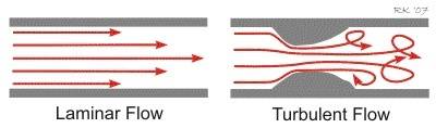

I have some confusion about how blockages result in the laminar/turbulent flow of fluids in pipes.
From my understanding, there is a certain diameter of a blockage in a pipe that will cause the flow to transition from laminar to turbulent (depending on the velocity of flow, etc.)
What is the relationship between Reynold's Number and this?
Is there any way to calculate the critical diameter of blockage that will result in turbulence?
I am thinking about this in terms of blood flow, where the narrowing or blockage of arteries may cause turbulence to occur.

SteamKing, I think what jabotabek is asking is how this behavior changes when you put an obstacle in the flow. You can force the transition to turbulence at a lower Reynolds numbers by disturbing the flow but if the Reynolds number is too low, then relaminarization occurs.

Do you know if there is any way to determine the critical diameter of a pipe which will cause turbulence? (See image)
The flow velocity, dynamic viscosity and pipe dimensions are known.

The Reynold's Number is a dimensionless parameter that describes the ratio of inertial forces to viscous forces in a fluid flow. It is calculated by multiplying the fluid velocity, density, and pipe diameter and dividing by the fluid viscosity. In simple terms, it represents the relative importance of inertial forces (tendency to continue moving) compared to viscous forces (resistance to flow) in a fluid.
In pipe flow, the Reynold's Number plays a crucial role in determining the type of flow, whether it is laminar or turbulent. At low Reynold's Numbers, the flow is laminar, meaning that the fluid particles move in smooth, orderly layers. As the Reynold's Number increases, the flow becomes more turbulent, characterized by chaotic, random motion of fluid particles.
The presence of a blockage in a pipe can disrupt the smooth flow of fluid and cause turbulence to occur. This is because the blockage creates a disturbance in the flow, increasing the Reynold's Number and causing the flow to transition from laminar to turbulent. The critical diameter of the blockage that will result in turbulence depends on the fluid properties and the Reynold's Number. There is no specific formula for calculating this critical diameter, as it can vary depending on the specific conditions of the flow.
