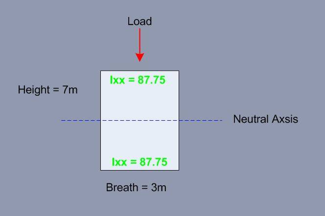

Given a a rectangle (Breath 3m, Height= 7m), the equation for 2nd moment of area is given by bh^3/12 so my value for the second moment of area is 85.75m^4 as shown below:-
I am trying to visualize what this number means?
Does 85.75 mean that i have 87.75m^4 of area above AND below the neutral axis as shown in green above?
Or
Does 87.75 mean that my total area furthest away from the neutral axis is 87.75?
Finally does the equation Ixx = bh^3/12 only apply to a single point which is at the centriod or along the neutral axis in the cross section?
Can anyone help?
Thank you.

Can i ask given my example what does 87.75 actually mean?
Does it mean that i have 87.75 of area above the centriod and 87.75 of area below the centriod?
I am trying to actually understand what the value means other than its a value the describes the resistance to bending.
Thanks
tomtomtom1 said:
Hi Trurle
Thank you for your response.
Thanks
1) You have a typo. Correct value is 85.75
2) 85.75 m4 is total rigidity (summing both above and below neutral line). If you take second moment of area integral from -h/2 to h/2 instead of using formula directly, the confusion will not happen.

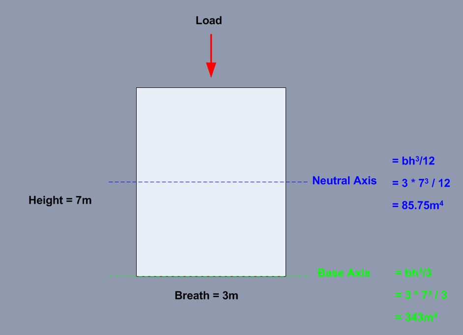

Your comment about the value 85.75 m4 being the total rigidity made a lot of sense to me until i took the second moment of area at the base thinking that the value for the total rigidity would be the same - but it was not.
I found out that the equation for the second moment of area taken from the base is bh^3/3.
When i applied this equation to my example i got a total rigidity value of 343m4 but the value should be the same as the cross section has not changed.
Below is a sketch of my thought process:-
Where am i going wrong?
Thanks
You are using the wrong formula. The one you used is for the case where y=d. The correct formula for a neutral axis at y = 1/2 d, as shown in your figure, is: bd^3/12 = 85.75.
Likes trurle
Hi JBA
I have to be honest i don't think i understand.
Are you are you saying that the equation for Second Moment of Area taken at the base is y=1/2 d? i thought it was bh^3/3??
I am trying to compare the Second Moment Of Area taken at the centriod with the Second Moment of Area taken at the base of the shape.
This is what i am trying to do?
I apologize, I misunderstood the issue of your confusion.
tomtomtom1 said:
I am trying to compare the Second Moment Of Area taken at the centroid with the Second Moment of Area taken at the base of the shape.
Your diagram and equation results are fully correct for the two cases. The Ix' for the y = h case is a derivative of the central axis Ix case done by applying the "parallel axis theorem": Ix' = Ix+Ad^2, where d is distance of Ix' from Ix.
See the below reference:
