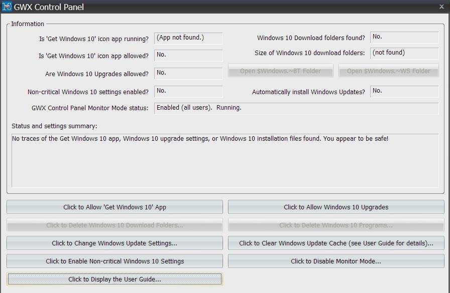

@dlgoff why do you find it comforting that a piece of software that has been download from an anonymous website without even an SSL certificate tells you "You appear to be safe"? Microsoft may not be perfect, but I know who they are and what motivates them, and that there are organisations with a lot more to lose than I have that ensure that when M$ screw up it is fixed, quick. Until EOL, which is less than a month away for Win 7.
Well, I'm safe from not getting Windows 10.
  • Haha
Likes atyy and pbuk
