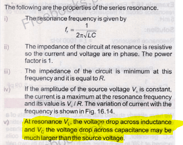

One property of series resonance circuit is that at resonance, the voltage across circuit elements R,L and C may be larger than the source voltage. I can relate it to vector analogy where component vectors may have larger values than the resultant and the phenomenon is counter-intuitive. This does not happen in DC circuits where sum of voltage across circuit components is always equal to the source voltage. Any useful intuitive explanation of this effect please?
A useful analogy for resonant excitation is to think about a swinging weight on the end of a rope, and you pushing it at the extreme of each swing with a small force and displacement with your fingertip.
As long as the losses are low for the swinging weight, it takes very small repetitive/resonant forces and small pushes from your fingertip to make it build up a large swing displacement -- much larger than the small periodic push amplitude of your fingertip...

It's simply sloppy! Don't use such sloppy books! There's no voltage across an inductance, it's an EMF. In time-varying magnetic fields, there's no potential for the elctric field due to Faraday's Law, which is one of the fundamental Maxwell equations,
$$\vec{\nabla} \times \vec{E}=-\frac{1}{c} \partial_t \vec{B}.$$

Thanks. I need more help on this please.
