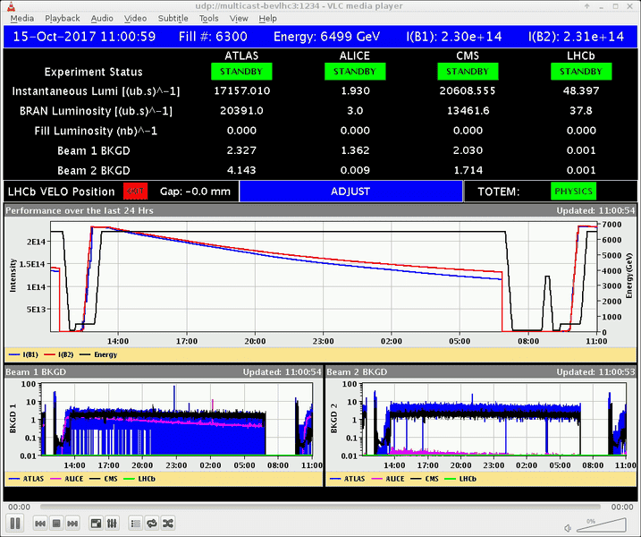

Was just wondering since I noticed the beam went up:
  • #54
That should be the run from the night to Monday.
Likes member 563992
