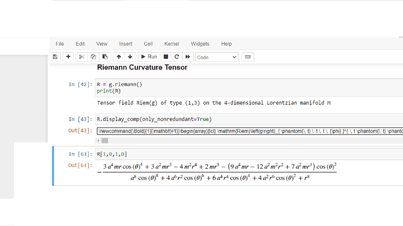

PeterDonis said:
has to be computed from the relevant components of the Riemann tensor; for an object with constant r, θ, ϕ this is Rtrtr.
I can compute the Riemann tensor! But are you suggesting that the Tidal force is derived only from the Riemann Tensor component ##R^r_{trt}## ? That component is shown below:
You can simplify it further by assuming that the stationary observer is in the equatorial plane, i.e., ##\theta = \pi / 2##. That eliminates all the ##\cos \theta## terms and leaves us with
\frac{2m}{r^3} \left( 1 - \frac{2m}{r} + \frac{3}{2} \frac{a^2}{r^2} \right)
which makes clearer how it compares with the Schwarzschild value. Note also that the Schwarzschild value for this Riemann tensor component, in Schwarzschild coordinates (which are what the Boyer-Lindquist coordinates you appear to be using for Kerr spacetime reduce to for ##a = 0##), is
\frac{2m}{r^3} \left( 1 - \frac{2m}{r} \right)
Computing the actual tidal force felt requires contracting twice with the observer's 4-velocity, which gets rid of the extra factor of ##1 - 2m / r## in Schwarzschild spacetime. In Kerr spacetime that exact cancellation does not occur and the formula for the tidal force felt is more complicated.

For the Tidal force, I think that the Weyl Tensor is a better component than the Riemann one. The latter is computing the change on the volume of object, whereas the former is computing on the distortion of the shape of object, which is a rather closer definition to my 2nd question. (the component is the Weyl Tensor with valence (0,4) ##C_{0,1,1,0}## )
