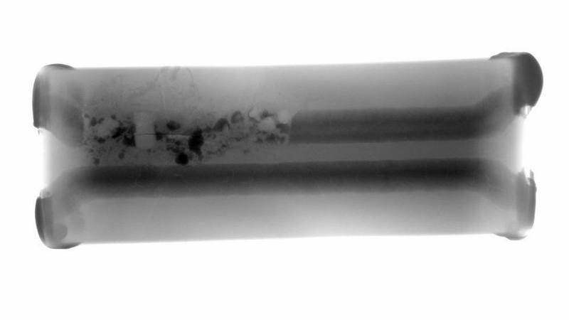

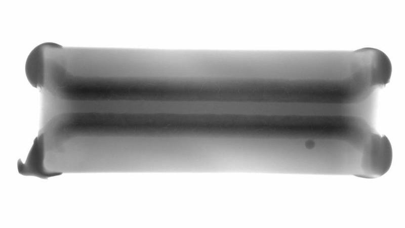

Sorry, not sure how to upload the files. The first 2 photos are of the same faulty ferrite bead which I had mentioned with no abnormality found. The 3rd photo is taken from another failed FB (2nd case) with cracked found inside. Both components are from different boards. The 4th is a sample from a good component.
Some background:
- Two cases of EMI filter failure. Both cases were found when the -12V input on the board was found shorted.
- Suspect a high current/voltage surge occurred.
- Components were removed from the boards for failure analysis.
- Comparison on the resistance measurement of both failed and good components were performed. Resistance measurements of failed components showed all leads are shorted.
- X-ray was taken on both failed components. Only one showed elements cracked within, and the other showed no symptom.
- OEM mentioned that there was a shelf life issue on this component. When it is removed from the packaging, the shelf life will be reduced to 3 months from the original 12 months. This part was later removed by OEM in year 2012.

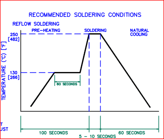

overly enthusiastic soldering at assembly heated it to point of insulation failure

solder bridge shorts terminals together - there's only 0.030 inch between the terminals and tolerance stackup could reduce that to 0.010 .

Wirenut and Berkeman, is my explanation on the x-ray clear? :P

Actually, on second thoughts, I could point out that the shadow of the Xray makes the device look like a directional coupler. Is that a daft suggestion, chaps?
Sorry but I'm confused...

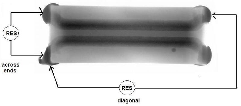

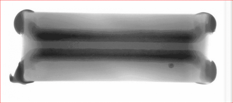

I can see why #3 might be shorted diagonally but are you saying that #1/2 is also shorted diagonally?
I share your consternation.

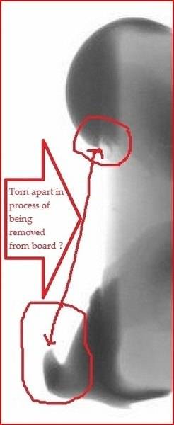

My first impression of OP's pictures was that the ends got torn and bent in process of removing the part
and we see the remains of either a solder bridge or a flaw in the board etch here - pads so close together they bridged in manufacture.

There is an anomalous dot in the x-ray. Do you know what it is? It can't be good, but I doubt any problem it caused would show up at DC.
What material is the case?
You are aware this item is no longer supported.
It's hard to imagine a DC short without some metal between the two bars which should show on the X-ray. There are conductive plastics and salt bridges to consider, but these seem unlikely.

Hi Guys, thanks for sharing and giving me all the valuable feedbacks and suggestions. Just to answer to some of your queries.
- The first two pics are from the same component (sorry for the confusion) and yes, it is shorted diagonally across the terminations when measured standalone after removal from the board.
- The board was conformal coated, not sure if tin whisker can be the possible cause of failure. Will further check on that.
- The OEM did mentioned about the storage issue and that's probably why they had discontinued this part.
Jim, the shadows you saw are the solder remaining after removal from the board.
so it should also be shorted between both terminations on each end as well then ?

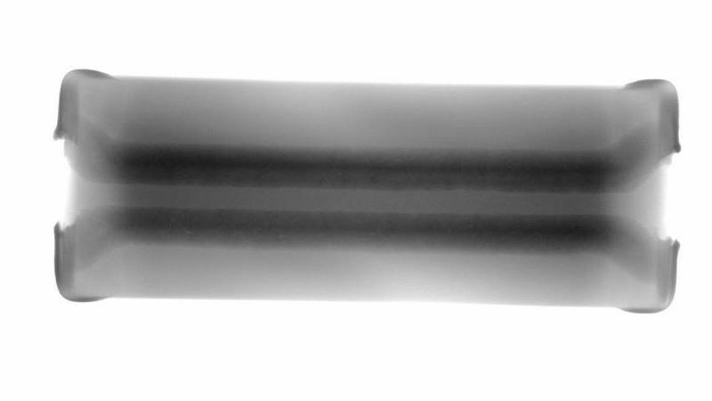

Dave
  • #34
Dave
Yes, Dave. All four terminations are shorted.
Likes davenn
  • #35
OK
pretty crazy when there is no obvious sign of a short
Is it really a short ... 0.0 Ohms or is it just low resistance a few 10's of Ohms or similar ?
I would warm up a couple of faulty ones ( that look OK in x-ray - like the one I posted) and see if it drives off any internal moisture
and test resistance again
I just find it so hard to see how you can have a short cct without anything obvious
