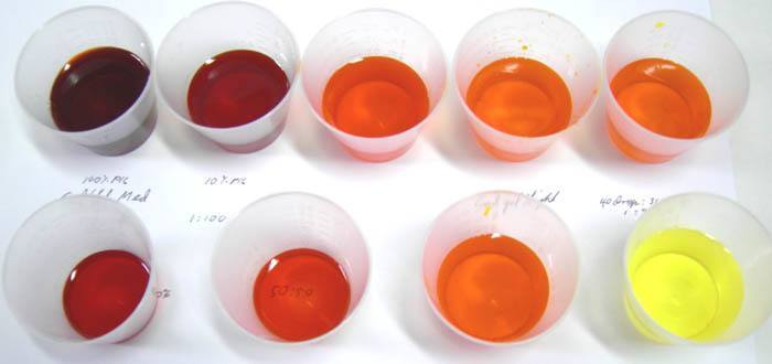

Here is a link to show how dark spectral yellow is in pigment, plus the story.
http://www.realcolorwheel.com/colorwheel.htm

You cannot "add blue light" in a subtractive colour mixing process (pigments or filters). If you want a more saturated colour with pigments, all you can do is subtract more light, making the surface darker. RGB colour synthesis is a lot easier to follow because the phosphors are fairly pure and bright. With CMY mixing, you can go more and more saturated but at the expense of brightness. The only way to produce a proper spectral yellow (i.e. a narrow band of wavelengths around the sodium yellow) is with a dielectric (interference) filter. A pigment can't do it - and it's particularly hard with a reflective surface. Insects and birds can have very saturated / bright colkours but not with pigments.
Those pictures of beakers of coloured water do not show spectral colours. How can they?
Printers and artists are pragmatic practitioners. They do the best they can to produce the colours they want. They do not claim to (or want to) produce spectral colours. I think there is an overlap in terminology which suggests some Physics that isn't really there in colour work.That doesn't matter at all - unless you try to equate the two fields of study.
