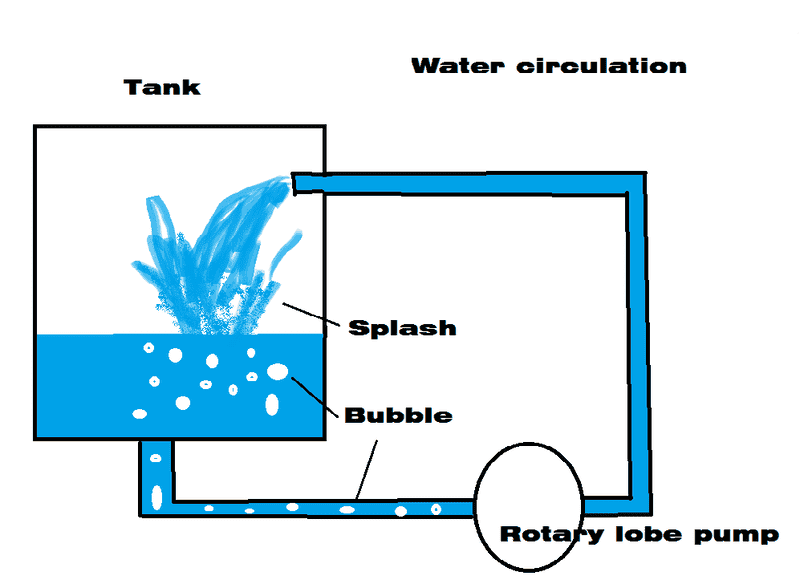

And I just wondered if this setting could cause "Aeration" and make bubbles into pipe which make "Cavitation" easier to happen??
Air entrained into the pump suction both causes symptoms akin to cavitation, and makes true cavitation more likely. The course of action required is installation dependent, but often involves the strategic placement of baffles and increasing liquid level height.
Do a Google search for "difference between entrained air and cavitation". This return hits the high points. http://www.pumpscout.com/articles-expert-advice/am-i-experiencing-cavitation-or-not?-aid102.html
I'll inquire again, what are the pump specs, and what type of fluid, temperature, motor speed, pump input shaft speed, pump outlet pressure, and is that the suction run outlined in yellow in the photo in post #3?

"Air entrainment and recirculation will also cause the same rumbling/rattling noise and high vibration as cavitation, as well as the recognizable impeller pitting damage."

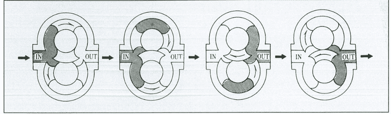

Is increasing pressure of pump outlet a factor to reduce cavitation in rotary lobe pump??
Do you mean by throttling the pump outlet valve as is common to reduce flow in a (non-positive displacement) centrifugal pump installation? A rotary lobe pump is positive displacement, and although to some small extent outlet throttling reduces flow (mostly, by increasing slip), the increase in outlet pressure at the operating point where flow rate has been reduced enough to prevent cavitation may exceed pump and/or pipe pressure ratings, it puts more wear and tear on the pump, and is a very energy inefficient way to reduce flow.
PD pump flow control is usually done by varying pump speed. Another possibility (one that isn't applicable in all situations) is to bypass part of the output flow back to sump, but this is also energy inefficient.

1.Could the slip which is caused by higher pressure at the outlet side add pressure to the inlet side and minimize the cavitation ??
2.And I have read pump troubleshooting and it said that
" Noisy operation=> Air or gas in fluid => Dissolved gas or naturally aerated products => Minimize discharge pressure."
What this means?? Minimizing discharge pressure to ensure bubble won't implode at the outlet side??

When outlet pressure is too high, discharge cavitation can occur.
No. Unless the pump is badly worn only a small percentage of flow is expressed as slip.
