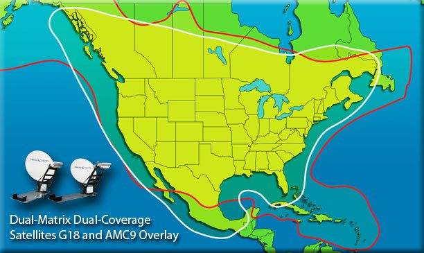

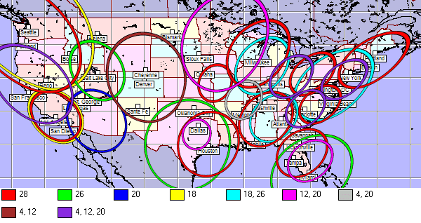

For a satellite it's the coverage area on Earth from a signal beamed from satellite to Earth from a transponder or group of transponders using an antenna.
It might be a traditional parabolic reflector or a modern phased array used to electronically steer the focus and direction of the beam to Earth or on the Earth to receive that signal. The size of that footprint depends on both the transmit and receive antenna gain (size), transmit power, receiver sensitivity, type of modulation and a host of other factors.
For an example most large DBS commercial networks have two types and typically use much higher frequencies for the down-link (KU and up 12-20+ GHz band for smaller antennas with high gain for consumers) than the up-link (C 5-7 GHz band large dishes for the providers that also provide resistance to atmospheric effects like heavy rain)
1. A wide coverage beam(s) on one or more transponders on the same channel or group of channels for general coverage of a wide area footprint.
1. Spot beams on other transponder channels designed to provide specialized coverage (like local TV channels)
for groups of large cities each with a much smaller footprint
and yes, you can and do have satellite to satellite communications on some systems.

I assume it is a 1000 km diameter circle target on earth, then. Rather than a 1000 km2 target?
That should be the Radius distance (I think, it's been a while since I worked with this stuff) but it's not always a circle.
Likes Vespa71

Phased array antennas now make it possible to use digital signal processing to synthesise many dynamic spot beams.
That is much more difficult with parabolic dishes, particularly in lower orbits.
