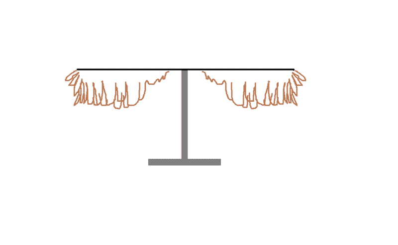

Oh, well I feel dumb now xD And I had to kind of just sketch it on google paint but my plan is to have one solid support base and beam, then the wings can be slide on or off if it needs to be moved or repaired

So the support structure is the "T" in your sketch? And the load is the brown hanging part?
That is correct or that's how I thought it should be made. Do you have an idea for a better way to do it?

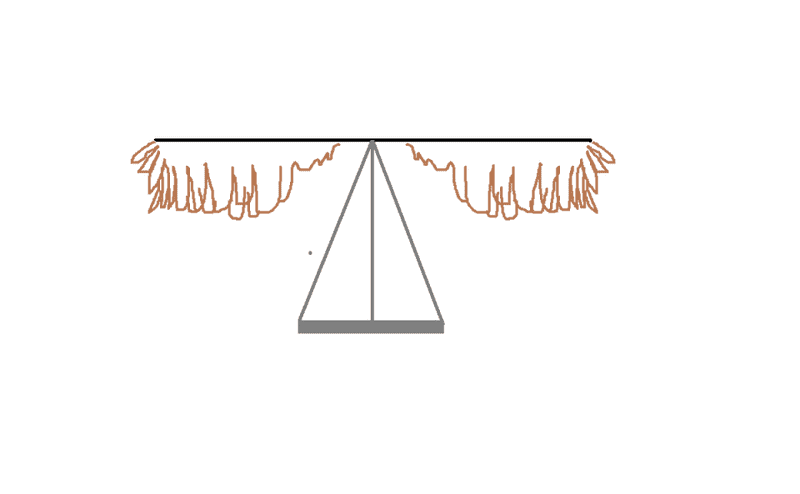

Triangles are usually better than "T"s. What kind of bracing can you add at the right angle joins? Evem better.can you design it as a triangle support or a rectangular support?
You mean something like this?

I see that you have added some new dimensional information to one of your posts since I first read it .
To have cantilevered platforms as long as 3 metres on a narrow central support pillar is not a realistic proposition .
Possibilities :
Use three or more support pillars with metal bracing at intermediate and end locations .
Use multiple trestle leg supports under the whole lengths of the platforms - probably much easier for you anyway .
