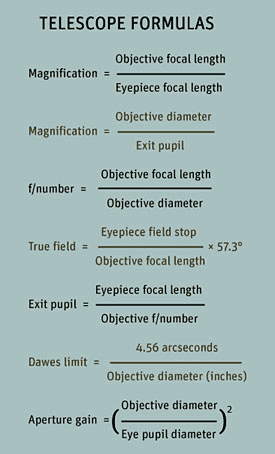

I'm skeptical regarding what to me appears to be your claim to increase magnification exponentially by ##n^4##, especially considering that ##2^4=16##; not ##8## (##2^3=8##).
The limits of optical telescope performance are well-established ##-## as @berkeman said:
berkeman said:
##\dots## telescope optics have been around for a long time and are a pretty mature technology.
From skyandtelescope.org:
Please ask yourself whether you've genuinely discovered something that everyone else has missed, including what prior constraint your prototype overcomes, and what possible optical expenses it may incur in doing so.
