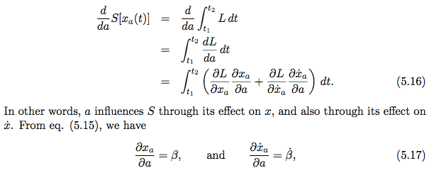

In the derivation of the Euler-Lagrange equation from the principle of stationary action, Morin, in his book, wrote that nowhere do we assume that ##x## and ##\dot x## are independent variables. But in phase space, they are independent variables.
Am I right to say that he should have said "nowhere do we assume that ##x## and ##\dot x## are independent functions" instead? This is because in (5.16), we differentiate ##x## and ##\dot x##, and variables cannot be differentiated. For example, we can differentiate a function ##y(x)## wrt ##x##, but we can't differentiate a variable ##x## wrt ##x## or a variable ##y## wrt ##x##. (If we do ##\frac{dx}{dx}##, we are differentiating the function ##y(x)=x## wrt ##x##.)

How do you reconcile Morin's comment that ##x## and ##\dot x## are dependent variables with the fact that they are independent variables in phase space?
I'm not sure I agree with Morin. 5.17 and 5.16 are fine even if they are independent.
Euler-Lagrange equation is an optimization problem, so the solution is more constrained than the functional that is being optimized. So ##x## and ##\dot{x}## are independent in the functional, but not in the solution. I think it's analogous to this simpler example. Consider the line

Can I say there are two ways of viewing (5.16), depending on the vector space you use to visualize the optimization?
If we use the position-time vector space, then we vary the trajectory ##x(t)## of the particle. In this case, ##\dot x(t)## changes accordingly as ##x(t)## is varied. Then the ##x(t)## and ##\dot x(t)## in (5.16) are NOT independent.
On the other hand, if we use the velocity-position phase space to visualize the optimization, then we vary the phase-space "trajectory" ##\begin{pmatrix}x(t)\\\dot x(t)\end{pmatrix}## of the particle. In this case, ##x(t)## and ##\dot x(t)## are varied independently. Then the ##x(t)## and ##\dot x(t)## in (5.16) are independent.
However, ##\frac{\partial x}{\partial a}## and ##\frac{\partial\dot x}{\partial a}## are related by (5.17) as the latter is the derivative of the former. Does this imply that not all variations of the phase-space "trajectory" ##\begin{pmatrix}x(t)\\\dot x(t)\end{pmatrix}## are considered in the optimization? But only those variations that satisfy (5.17)? If so, then ##x(t)## and ##\dot x(t)## are NOT varied independently. And the function ##x(t)## and the function ##\dot x(t)## in (5.16) are NOT independent.
Also, consider the term ##\frac{\partial L}{\partial x}\frac{\partial x}{\partial a}## in (5.16). Can I say that the ##x## in ##\frac{\partial L}{\partial x}## and the ##x## in ##\frac{\partial x}{\partial a}## mean slightly different things, though they are both symbolized in the same way? The ##x## in the former is a variable (which can take on certain values), whereas the ##x## in the latter is a function (which is a map).
