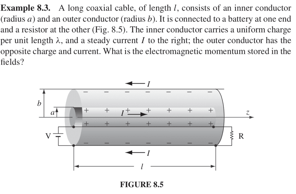

Why is the Electric Field outside this wire not zero?

Not a homework. Just want to understand a (should be simple) example.
Why is E not zero?
Not a homework. Just self-studying electromagnetism.
I am stuck at understanding the very beginning of the solution steps in this example:

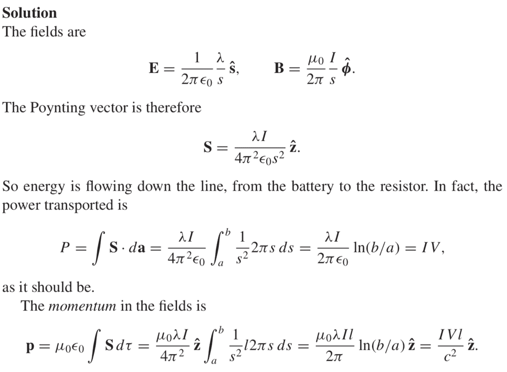

The E as given in the solution is the field away from a long straight line with charge Lambda. That's clearly not the current configuration.
E should be zero by Gauss law, shouldn't it? ... Net charge is 0.
David Griffiths Electrodynamics 4th Edition, p. 368

Ask yourself: The field where?
Outside is 0 from Gauss Law.
Inside conductor is 0 (after equilibrium).
So there are two fields, one on the outer surface and one on the inside contacting surface?
Am I in the right direction?
The fields are only at the surface?? Please be a little more complete in your description. Electric field lines start on a positive charge and end on a negative charge.

What about E field between a and b? By Gauss' law?
Likes bryanso
Thank you all. Got it. I knew I missed something very simple. I got misled by the general rule of thumb that there is no E inside a conductor. But this is not a homogenous conductor here. I can proceed now.
