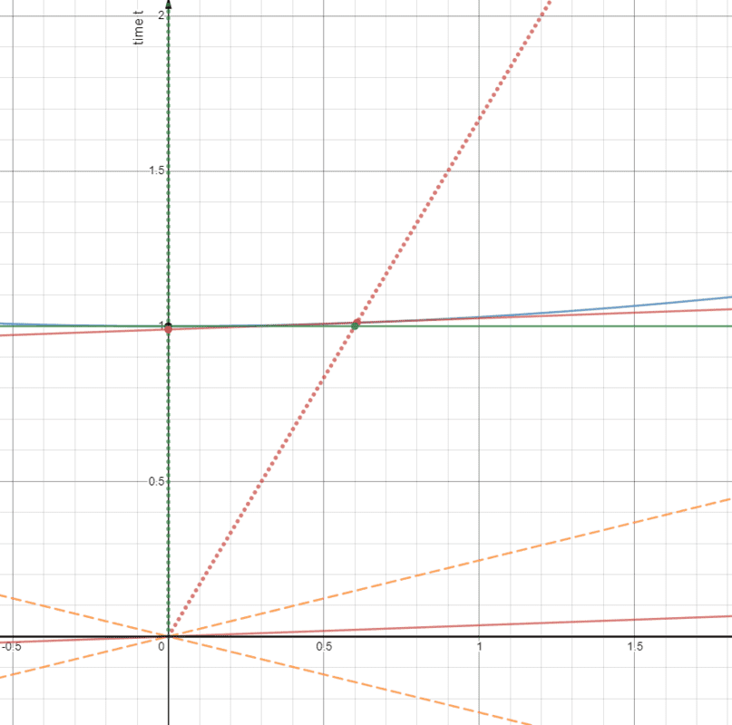

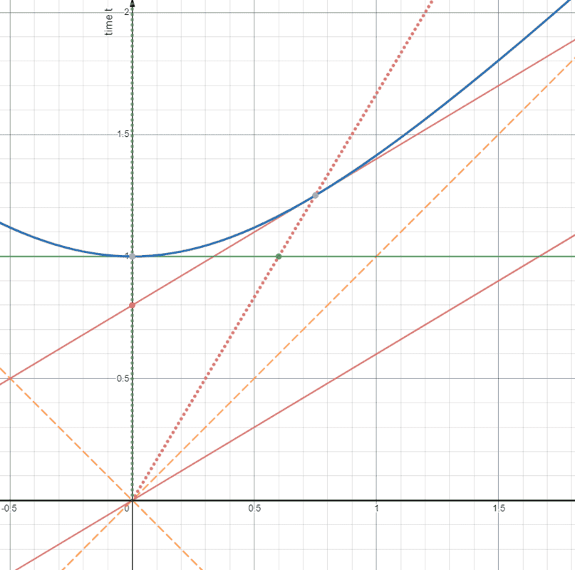

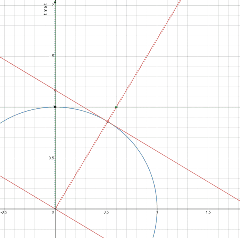

You can play around with this idea in my visualization (time runs upwards)
https://www.desmos.com/calculator/r4eij6f9vw
- The unit-hyperbola (the "Minkowski circle") is in blue.
This figure is unchanged by a Lorentz boost.
- The red dotted line is the [timelike] observer-worldline.
- The red tangent line is the prototype for "simultaneous events according to
the red-observer".
- The red-observer's [spacelike] x-axis is drawn parallel to that tangent line.
Here is the E= +1, Minkowski case:
Play around with the E-slider to change signature to see the Galilean and Euclidean analogues.
Here E is approaching 0, the Galilean case (displaying the opening of the light-cone):
(Note how the tangent lines associated with different radii will coincide when E=0.
That's "absolute simultaneity".
Further note, that:
Generally, the tangents do not coincide.
Our "common-sense" Galilean "absolute simultaneity" case is the exception... not the [general] rule.
Here is E= -1, the Euclidean case:
