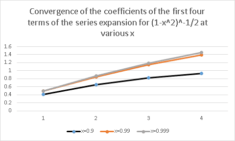

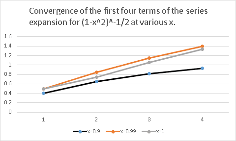

I don't see that the sums will rise without bound for these series
Close to x=1, four terms is nowhere near enough for precision, so your result is nowhere near correct. No time at the moment to do a proper analysis so, back of the envelope, you are going to need at least a hundred terms to get anywhere near precise results for x=0.99. (Edit: commuter trains are quieter than libraries. The rule seems to be that you need approximately ##1.7\times 10^k## terms to get within 1% of ##\left(1/\sqrt{1-x^2}-1\right)## when ##x=0.999\ldots## with ##k## 9s - so x=0.99, you need 170 terms, x=0.999 you need 1700, etc.)
Edit 2: Notice that your own graph is showing you this. Only the black line is beginning to flatten out - so you don't have a good approximation for any of them. I expect you need around 17 terms to get a decent "final" value for the black line. But you need around 1700 to be able to see your upper two lines separating.

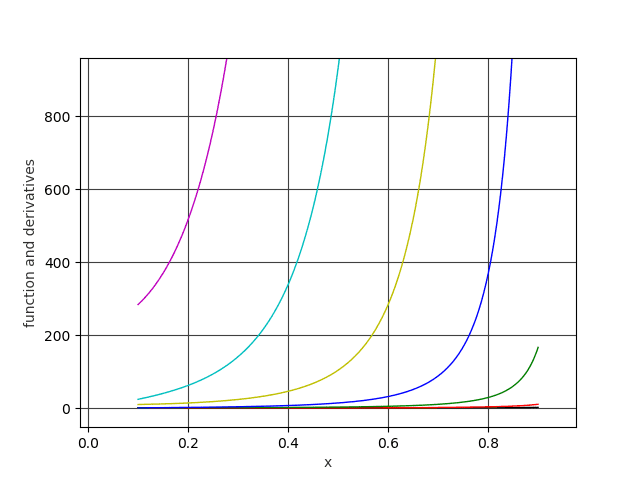

Since I have been working on calculating higher derivatives for another purpose, here are the first six derivatives of ##\frac {1} {\sqrt{1 - v^2}}## evaluated between ##v = 0.1## and ##v = 0.9##.
Key: black = value, red = f', green = f'', blue = f''', yellow = f'''', cyan = f''''', magenta = f''''''.
