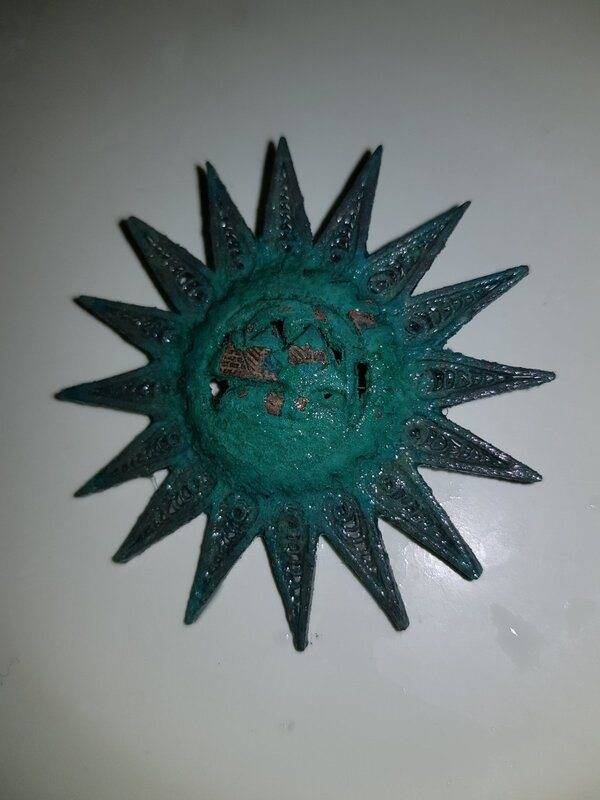

I soaked the following school medallion in water with salt for 20 plus years in the attic and at that time I didn't know copper could corrode and make green oxides. I also didn't think about it much and just forgot about it. I brought it down just today.
I read just a while ago that hot salty vinegar can help remove the oxides. But how can I apply it to all the surfaces, will soaking it for 30 minutes be ok or will the cooper get removed as well?
Can one use electrolysis and does it work for cooper oxide? What chemical(s) could be or are used in green cooper oxide removal?

Verdigris is not an oxide, more like some mixture of basic carbonates.
I doubt acetic acid will work. First, it is too weak, second, it was used in the past to produce verdigris, so even if it will remove some of it, it will probably also promote further corrosion.
I would go for the hydrochloric acid. Not too concentrated though, definitely something below 5%. I strongly doubt 30 minutes would be OK, but the only way to check is to try experimentally.

It's one of a kind medallion that i can't get again. So I won't experiment. I can just let jewelry service center remove them. Unfortunately. Their experiences are only with gold and silver. No one use copper or brass in jewelry. Hence the reason I need to be familiar with all kinds of cleaning especially chemical is to make sure they won't ruin it. Or know what they are exactly doing. They may try their techniques in cleansing gold and silver to it and it may not be compatible.
So others, kindly give all kinds of ideas how to separate the Verdigris from the copper/brass with least or no damage to the latter. Thanks.
Experimental part refers to the time required - this is rather unpredictable and depends on many factors. Diluted hydrochloric acid is a safe bet - it won't touch the copper itself and it will definitely dissolve verdigris.
Note that the copper is already potted with the corrosion under the patina, even if you remove it the surface won't look as it looked before.

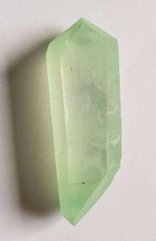

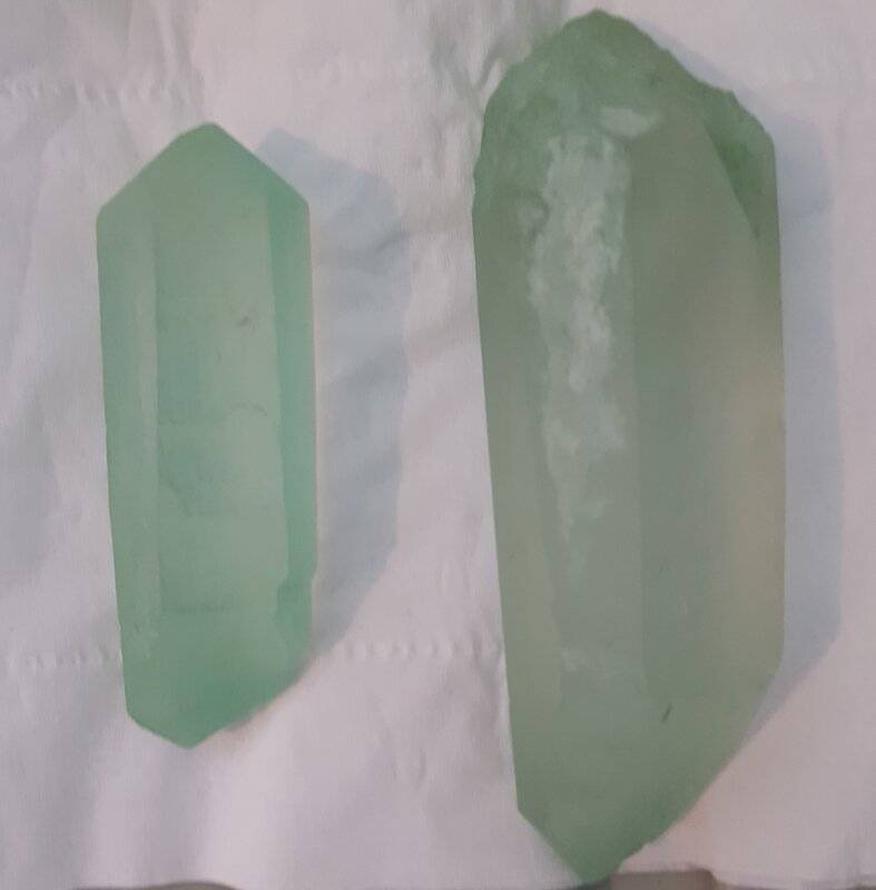

By the way. In the same container with water and salt and medallion i put some crystal as i was trying out piezoelectricity. Water and salt is a conductor. For 20 yrs it is soaked there. So how did the verdigris from the copper transfer to the crystal? I tried using soap and water and scrub yesterday but the green hue of the crystal can't be removed. Will soaking in vinegar remove it? I don't want to damage the surface as i want to try piezoelectrity now and it may need smooth crystal surfaces. Also I am 100% sure these were clear color before as i have others i sold already. Natural green crystal is expensive.
There are lots of green crystals. There are lots of crystals in general. I have no idea what kind of crystal you started out with. I imagine after 20 years, some of the crystal's cations might have leached out and been replaced by copper cations, giving it a greenish hue. This would mean that no amount of buffing or polishing will take out the green color--it's part of the crystal structure now (at least to a certain depth, depending on diffusion rate of cations in and out of the crystal). However, there's no way to answer your question without knowing what kind of crystal you started with.
Also, only crystals with certain kinds of structure are piezoelectric. Are you sure you have one of those?
It is just generic clear quarts crystal. I know there are pink and green crystals. But I am sure it is not these colors.
If crystals colors can be changed by replacing the cations. Are there commercial processes where this is done? Is your description about cations the same as presence of hydroxyl groups or molecular water in the crystalline structure?

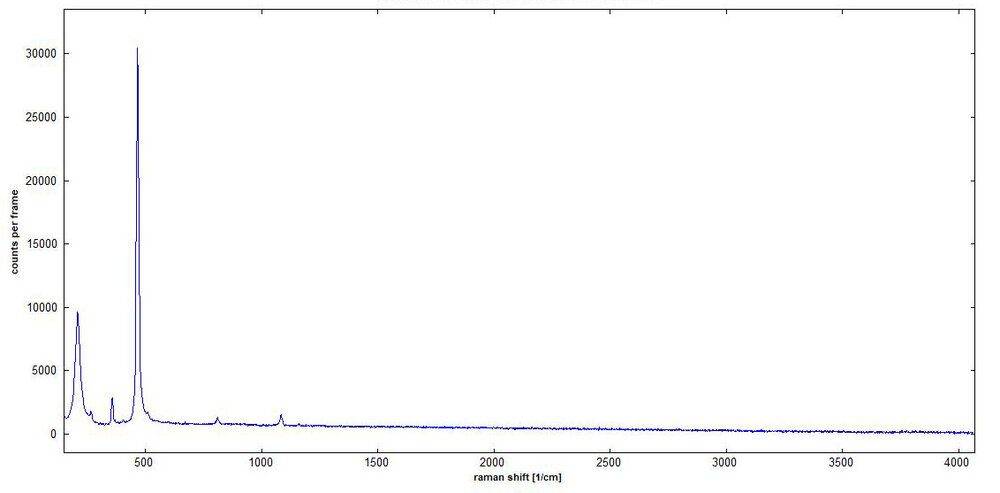

Yesterday I scanned it with a Raman spectrometer. This was the reason I removed the medallion and crystals in the salt water in the first place. To scan the crystals and take picture of the medallion to ask what is the green stuff. This is the green tainted quarts Raman spectrum.
What bonding produces the peak near 500 cm-1? This is zoom of the same crystal Raman scanned.
20 years ago. I was young. And my testing with Piezoelectricity unfinished. I just read then about shoes having crystals where stepping on the floor can charge battery put in the shoes and cellphone (when battery charge is gone). Imagine you are lost in the forest and your cellphone has drained battery.

I soaked the quartz in vinegar for 30 minutes. 50% of the green stuff got loose. So I tried cleaning the medallion with vinegar. 20% of the green stuff got loose. I couldn't remove the rest, but some parts of copper covered by the verdigris were visible again. This begs the question. Does verdigris forms on top of copper, or does it replace the copper itself?
I don't trust the jewelry cleaner to clean it because they may use very strong chemical that may melt the copper. What chemicals can melt the copper?

Dunno. Elemental silicon is at 521 cm-1 but I doubt that’s it. Maybe check a database. Raman usually has pretty high resolution.

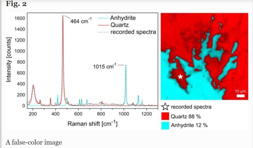

I found here the Raman spectrum of quartz, which matched mine in cm-1. The strokes shift Raman peak is at 464 cm-1. Anyone can explain why it varies from the Elemental silicon at 521 cm-1?
In situ Raman imaging of high-temperature solid-state reactions in the CaSO 4 –SiO 2 system | SpringerLink
My spectrum:
Because it’s not elemental silicon. Different compounds have different Raman spectra.
Completely different bonding situation. Silicon contains Si-Si bonds; quartz contains Si-O bonds. To be a bit over-simplistic: Vibrational spectroscopy (IR and Raman) characterises bonds, not atoms. X-ray spectroscopy, on the other hand, would tell you what elements are present (it looks at the energies of core electrons).

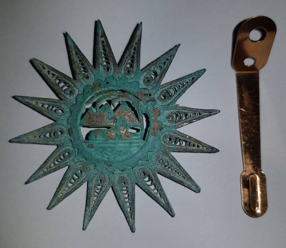

What if the medallion is composed of cooper/iron alloy? How to tell? I used magnets and it didn't stick. Are magnets supposed to work on cooper/iron/whatever alloy? The following is after using brushes, soap, vinegar scrub for 20 minutes.
Look at the copper strip besides it. When I got the medallion about 25 years ago. It didn't look like copper. After spending 5 years experimenting on it. I stored it for 20 years.
Just wondering. Can anyone make out what images are in the center? Have you seen anything like it? I want to know how rare it is or just sold in market elsewhere.
The image seems to be the Egyption Pyramids in the background, the Sphinx in the foreground, and a Palm tree on the right and top.
Just as a wild guess, I suspect it is a tourist trinket someone got an a visit to Egypt.
Very good. You are the only one who see through the verdigris coating?
Bottom of it is the Nile River.
I bought it from someone who got it from Egypt. I don't know if this was mass produced in tourist shop or specially made limited edition. Can someone from Egypt please share if this item is common in shop. So I can just get another one if I want to use it again.

Well. Once I removed the verdigris. What can I paint it with? I'll sell it.
How much is this being sold in Egypt?
Does Egypt have internet? Any members here from Egypt?
  • #35
There are a couple of alternative approaches to consider, that I may be able to expand upon later.
Just on principle, I would experiment on copper coupons before trying unfamiliar chemistry.
There are two detailed articles about making and characterising verdigris:
https://pubs.rsc.org/en/content/articlehtml/2017/dt/c7dt03288a
https://pubs.rsc.org/en/content/articlehtml/2018/dt/c8dt01758a
Judging by the crystal structure, I don't see any ions being sufficiently mobile for electrolysis to work at practical temperatures. There is also the possibility that copper from the cleaner parts is dissolved preferentially, making the damage worse.
I would consider heating the object to partially or completely decompose the compound. This could be done in a neutral or reducing atmosphere to avoid excessive oxidation, but a fair amount of decomposition already occurs at about 200°C. Speculating here, the decomposition products may lend themselves to chemical cleaning.
A more off-the-wall approach would be to treat the compound as a hydroxide ceramic and look at ways of breaking up the hydroxide structure. A low melting point salt bath might do the trick. My starting point would be a mixture of carboxylic acids and perhaps a metal carboxylate. Unfortunately, phase diagrams of organic chemicals is not the sort of information that I have at my fingertips
Likes jake jot
