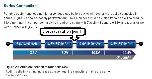

Bernie separates his cells to check for failure.
Pick a pair that's been having trouble. Don't disconnect them, just measure... What is voltage across each when being charged? And when loaded? Check the AC component too by switching the dmm to AC. Feel one with each hand - are they same temperature?

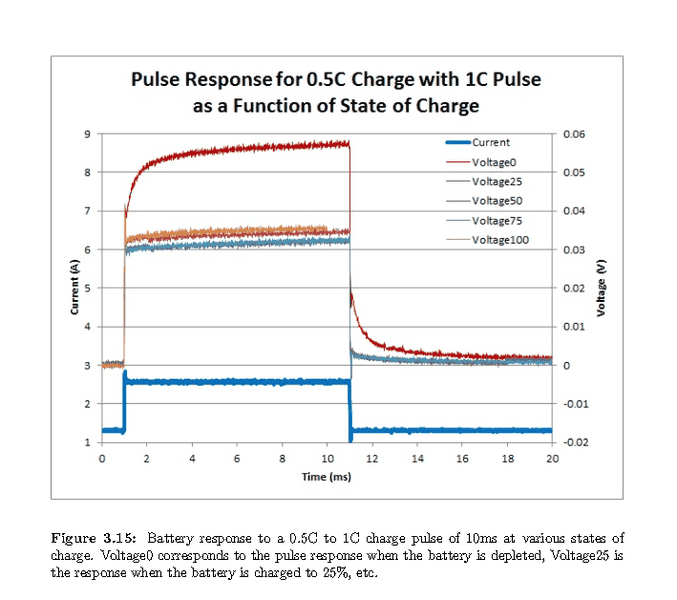

PWM inverters draw high frequency current pulses. Are his filtered ?
What about that charge controller output? Is it pwm too?
Reason i mention that is , knowing nothing about his physical battery wiring layout i wonder if it has substantial inductance?
If so it's possible some battery pairs carry the lion's share of the high frequency current. High frequency pulses heat the electrolyte lowering cell voltage, perhaps starving other battery pairs on float..
https://tspace.library.utoronto.ca/...3/Sritharan_Thuwaragan_201206_MASc_Thesis.pdf
While he's checking DC, measurements of the AC ripple across several batteries might give a clue.

I'm still scratching my head as to why the order of the batteries makes a difference. It makes absolutely no sense.
And your one paragraph is rather incomprehensible:
BernieM said:
After consideration of this problem recently, I wondered if it might not be better to carry the common between two solar panels on the roof and tie it to the common (+/-) post that tie the two batteries together. In this way both batteries would see 12v from the array and charge simultaneously, rather in a cascade fashion.
"carry the common"?
"cascade fashion"?
Can you doodle a schematic for me. I've had a lifelong difficulty with language, but, I've found that a picture is sometime worth more than a thousand words.

Thought experiment:
Imagine yourself very small and seated at the observation point with a "charge counter", a hand held gizmo that increments by one count every time a single quantum of positive electric charge moves past your observation point in the direction of the arrow.
When it increments 6.24 X 1018 times a second that's one amp of current flowing.
Look up "Coulomb".
Since the charge of one electron is known to be about 1.6021766208(98)×10−19 C,[7] 1 C can also be considered the charge of roughly 6.241509×1018 electrons
An amp is one Coulomb per second flowing past a point. It's that simple.
Observe those charges can't get out the top or bottom of the battery string because of the insulation..
So,
All the charges that go in the left end must come out the right end, traversing all four cells.. You could observe anyplace in the series string and get the same current.
That's why things in series have same current. It's their voltage that can differ.
not talking down here, just it's important to get the basic definitions nailed down straight early on. Saves a lot of unlearning later.
Rethink your sulfation conclusion?old jim

  • #33
BernieM said:
But don't forget a battery cell is an electrochemical reaction and a cell is not a carbon resistor. One has to capture 2 electrons to reverse the process to charge a cell as I recall. The earlier comment made in one of the posts was that you have X coulombs of electrons flowing in the circuit, a coulomb of course being a fixed quantity of electrons. When you have electron capture, you have to be subtracting from the total number of electrons flowing once capture occurs.
nope. That's the source of your confusion.
See
http://ecee.colorado.edu/ecen4517/materials/Battery.pdf
BernieM said:
However, I think this could be a power density issue.
Could be.
Might also be a ripple current issue. I don't know if it is, but good troubleshooting rules out the possibilities one at a time.
Industry papers on effect of ripple on batteries confirm it heats the electrolyte and to an extent the plates too. It shortens battery life.
The heating is easily measured. Do your batteries get warmer when running that inverter from them?
http://www.cdtechno.com/pdf/ref/41_2131_0212.pdf
http://www.battcon.com/PapersScanned1999/GernerPaper1999.pdf
http://www.ecmweb.com/ops-amp-maintenance/get-know-your-battery
Ripple current — Excessive ripple will cause internal heating of batteries. Ideally, ripple current should be less than 5A for every 100Ah. However, ripple current says more about the state of the charger than the battery. Ripple current does not provide any information about SOC, capacity, or SOH.
You ought to look at your inverter's current draw with your oscilloscope if only to rule put the ripple issue .
However - all that said
Yours is not the only inverter of its type out there. Were this an inverter issue the brand would have a reputation as a "Battery Killer".
Which leads me to think it's a battery issue.
