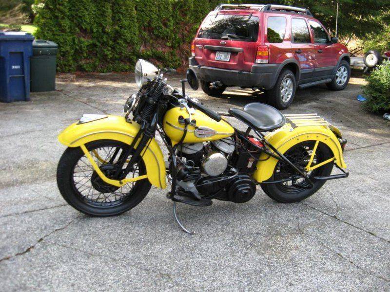

Four of my five bikes run carburetors, and the oldest of the bunch has a manual advance points ignition. The black lever on the side of the tank is the shift lever. The clutch is foot-operated.
Extra low-tech -- 45 c.i. flathead engine, pulling maybe 20 HP. No suspension in the rear, and only about 2" of travel in the front forks. The seat has about 4" of travel though, so it absorbs a lot of the bumps in the road. 1946 Harley-Davidson WL, very similar to the many thousands that were produced during WW II.
Likes sophiecentaur and BvU
That's a nice bike
Andy SV said:
That's a nice bike
Thanks! My other old one is almost as old, and similar in style, but slightly newer technology - OHV 74 c.i. engine, and running an electronic ignition. It's still manual advance though, via a throttle-like control in the left handgrip.
With regard to other comments in this thread, there's no chance of the rear wheel coming off the ground when the front brake is applied with either of these bikes.
