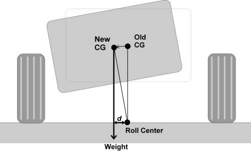

Love the discussions here but I have a question concerning RC location. For an asphalt car I some saying it should be located a little to the left annd other saying is should be located a little to the right. Why one over the other?
  • #851
hello drobbie
We discussed roll center location and height on post # 229 page 15, post # 691 on page 34, it all goes back to post #62..AKA the neighborhood fat kid theory of down force.
a thumb nail summary..we need down force to stick the right front tire. We can do this with body roll or aero down force. If we have too much down force we over heat the right front tire and push up the track..no stick!
We locate the front roll center to the right side to add down force on the tire.
If we are using the race cars body aero dynamics to cause down force then we have to move the front RC to the left of center to kill off down force.
There are some wacky set up that have the front RC on the left side in static set up but it migrates to the right side under roll and droop.
we need even more offset on dirt to stick the right front...

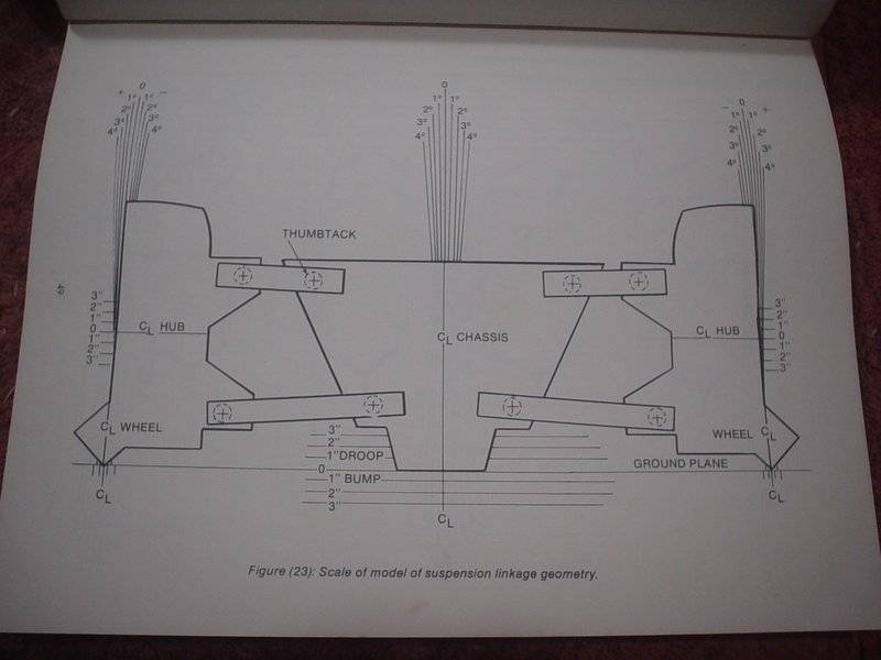

It has occurred to me that I may be misundestanding rear steer. Somewhere in all of the data I have viewed in the last couple months, I have in my head 1/8" as an amount of maximum rear stear. I have been measuring how much the axle moves as if to shorten/lengthen the wheel base. Should I be looking at it as how much the tires toe ?
Thanks, Logan
  • #858
Rear steer is when the differential housing moves up and down and changes the wheel base. Growing wheel base means rear roll over steer. This action will not cause toe out in the classic sense because the rear end is one solid piece and the rear tire center lines will be the same during roll as it is static. The old notes from the Monte Carlo street stock I worked on says when I was simulating chassis roll ( 3 inches of right-rear bump and 1 inch left-rear droop), the metric chassis pulled the right rear tire forward almost 3/8 inch more than the left. This will tighten the car on corner exit or anytime the power is on. I think we ran 1/2 inch one time but was too squirrelly at power on.
I do know dirt late models run insane amounts of rear steer to hook up...
  • #859
That is exactly what I get, if i go 3" bump right, 3" droop left it goes to about 7/16". I have found that doop causes the least movement. when i put bump in it starts to move greater amounts. I trIed raising the ride height to make it better, and it does, but the ride height is probly going to be to high. What do you think about limiting the roll of the car to help minimize this situation?
