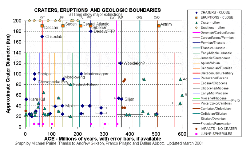

Would it help if we look at this overview of our current understanding of major and minor extinctions, bolide impacts and trap volcanism?
Would an orbit of 32 My still be stable enough?

Thanks Andre.
Is there some explanation to go with this summary? For example, what's the difference between 'CRATERS - CLOSE' and 'Crater - other'? And what are 'IMPACTS - NO CRATER'?
Also, do you know if anyone has a chart of (well documented) iridium spikes, shocked quartz, tektites, etc?
Finally, what is the cratering history on the Moon, over the last ~600 million years? Especially of large (>50km) craters.
PS I did some surfing on the 'Bedout/PT?' crater - it sure isn't a Chicxulub, is it!
Sorry, it was a rush post. But here is the source with great links, like http://www.sciencedirect.com/science?_ob=ArticleURL&_udi=B6V61-4H9YCC8-2&_coverDate=11%2F15%2F2005&_alid=329050930&_rdoc=1&_fmt=&_orig=search&_qd=1&_cdi=5801&_sort=d&view=c&_acct=C000050221&_version=1&_urlVersion=0&_userid=10&md5=9a2d1584bf5503c2f8977d02ae9d0922
It appears that the "Close" refers to a geologic boundary associated with extinctions.
