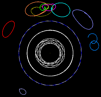

Mars has a few. The most famous is named Eureka. They actually come closer to Earth than Earth's trojans would, and unlike Earth trojans, they will have an opposition where they lie almost directly opposite the Sun.
Here's a screen shot of Mars' trojans in a frame rotating with Mars' orbital period:
http://www.orbitsimulator.com/gravity/eureka.GIF
I think I got the list from Wikipedia, but interestingly, a couple of the asteroids in this image do cross the position Mars which should exclude them from being called trojans.
Someone once told me that Cruithne was not considered a trojan because it crosses the Earth's L3 point into a full horeshoe orbit. I'd be more inclined to think that Garth is right, and it should be called a trojan.
Here's an animation of Cruithne's orbit in a frame rotating with Earth's period. Only one side of its kidney-bean shaped orbit has "apparent repulsive properties". Due to inclination, the other side, while it looks close in the animation, has a lot of z-axis distance that prevents Earth's gravity from getting a good grip.
http://www.orbitsimulator.com/gravity/acruithne.GIF
Earth also has 2002 AA29 in a horseshoe orbit. This one is interesting because sometimes it leaves the horseshoe configuration and enters a quasi-orbit around the Earth. Here's a screenshot of its orbit: http://www.orbitsimulator.com/gravity/2002aa29_1.GIF
