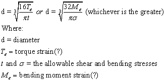

I have just found another couple of equations for determining shaft diameter, from a book. I have copied them out exactly as they appear in the book (click on link below, or see attachment):
http://img83.imageshack.us/img83/300/shaftequationmr3.gif
Some of the nomenclature is guessed, as the book is not very clear in explaining its usage of symbols.
Again, my problem with those two equations is knowing what to put for the allowable shear and bending stresses and the bending moment strain (presumably these are functions of material properties too, and not dependant upon exact dimensions of the material to be used in a shaft?)?
The first equation in that image is just Equation 4 rewritten for D and is probably still the more useful one. Do you know the difference between yield strength and ultimate tensile strength?

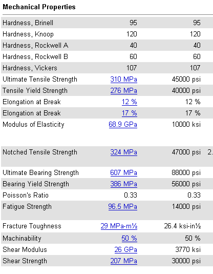

I think I understand this but if someone could confirm if I am correct, I would be very grateful.
For the diameter of a solid shaft:
D = 1.72 (Tmax/σmax)1/3
Example calculation:
I need a shaft that can cope with 10Nm. The shaft material is to be 6061-T6 aluminium (the spec’ sheet for which is partially posted below as an attachment). So the calculation would be:
Diameter = 1.72 * (10 / 207)1/3 = 0.027697262 = 27.7mm
So, basically the relevant section of a material’s spec’ sheet (when designing drive shafts for torsion) is the ‘shear strength’ figure, which for 6061-T6 aluminium is 207Mpa. Is that correct?
Hi Ascetic. Couple problems. The equation you're using is correct, but the 1/3 is an exponent which means they are taking the quantity (Tmax/σmax) and raising it to the 1/3 power. Note that this is the same as taking the cube root.
Using your numbers, and correcting for the exponent, you should get 6.26 mm.
However, that's not all of the issue. A drive shaft is under cyclic loading, and even if it weren't, you shouldn't use a material right up to the point that it will start to deform (ie: yield strength). There are "factors of safety" which are applied depending on the accuracy with which you can predict stress. Also, because of the cyclic loading, there is a fatigue issue.
If you can be certain the maximum torque will not exceed 10 Nm, you can use that as the maximum torque. However, you may want to consider other operating conditions which could increase that value.
You also should examine how the stress may cycle in this material. There's too much to explain regarding fatigue, so rather than go through it, I'll simply throw out a value which I think would be reasonable for the maximum allowable shear stress in this particular material, which is around 60 mPa. Much more than that and cyclic stress could cause it to break.
Given the 10 Nm for torque and 60 mPa for allowable stress, you should come up with a diameter of 9.5 mm.
Note also that drive shafts are often hollow tubes. This puts more of the material under stress and reduces weight. The same reference you used for the solid shaft has an equation for the hollow shaft. You could use that one if you decide to use an aluminum tube instead of a solid shaft.
That's the short response. There's a lot to designing such things, and I really can't put it all in one post for you. Doing a thorough stress analysis on the drive shaft might also include other factors, and a Mohr's circle might be called for. A Goodman diagram for fatigue would help narrow down what maximum stress you should use, and there will inevitably be stress concentrations along the shaft which should be considered. Design often comes down to determining to the best of your ability, all of the factors you must consider, and then using your best judgment, determining what factor of safety you should add to that.

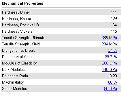

Thank you very much, QG.
Thank you for correcting me on the 1/3 exponent issue! That could have caused a few upsets! – Although at least my drive shaft would certainly not be under-engineered had I not realized the error of my calculation!
A new problem for me now seems to be a lack of material specification data on shear strength. The information I posted as an attachment on Aluminium was only used as it was the first spec’ sheet I found. I actually intend to use a much stronger material, as the shaft has to be as small as possible (which is why it will be solid). Although the Aluminium spec’ sheet contained specific shear strength data, it seems to be almost alone in doing so! I searched through the website it came from ( www.matweb.com ) and I clicked on the material data pages for other materials such as different types of steel. Unfortunately the steel spec’ sheets I looked at contained no listings for shear strength, only shear modulus (and modulus of elasticity, etc.). So I am not sure what I am to do now? I will search for other metal databases, but I sense I will not have a lot of luck.
What I am wondering is this: is it possible to determine a material’s shear strength, or strength to resist torsion, by looking at other figures on the spec’ sheet? I have attached a copy of the main spec’s of a particular grade of steel (also found here: http://www.matweb.com/search/SpecificMaterial.asp?bassnum=M1015G ). Is it possible to determine a metal’s torsion resistance strength by examining the information given in that spec’ sheet alone?

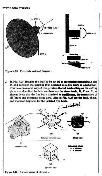

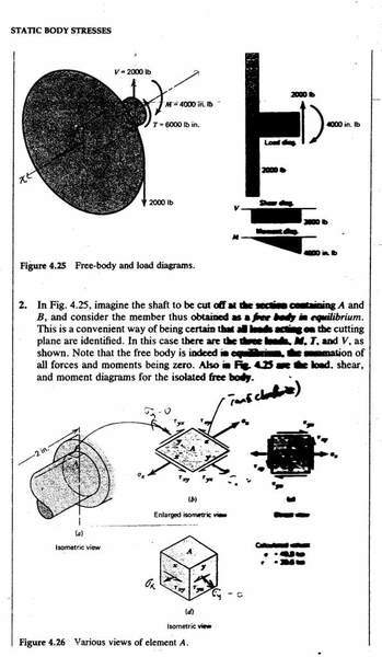

Hi guys,
I have a general question about torsion in shafts.
I know that the shear stress due to pure torsion of a solid round shaft is a maximum over the entire surface, and is of magnitude Tr/J. However, how does one account for the direction of the shear stress when performing a Mohr's circle analysis, or generally combining it with other stresses that may be present?
Take the example of a shaft with an attached pulley, which experiences combined shear, bending and torsion:
At the top of the shaft cross section (element A), where the bending stress is maximum and positive, and direct shear stress is zero, it is clear that the bending stress is in the axial direction, and that the shear stress due to torsion is as depicted. The Mohr's circle can then be constructed with the points (Mc/I, -Tr/J) and (0, +Tr/J) forming the diameter of the circle.
But what if I wanted to represent the stress state at an element on the side of the shaft? That is, at a point on the surface, but 90 degrees clockwise from element A, where the direct shear would be maximum (4V/3A). Is the torsional shear stress not then on a different plane to that at point A - a plane oriented 90 degrees from the one at point A? How does one then combine the direct shear and the torsional shear, and construct the Mohr's circle for that point?
Thanks in advance,
Benson
Hi again,
I think I solved my problem...
Using the same coordinate system they are using, the stress state on an element 90 degrees clockwise from element A would be pure shear (all direct stresses are zero), but this time in the x-z plane, and the magnitude would be Tr/J + 4V/3A. This gives a Mohr's circle of a radius equal Tr/J + 4V/3A, with the principal stresses being +/-(Tr/J + 4V/3A) and at an angle of 45 degrees.
However, on an element 90 degrees counterclockwise from element A, the direct shear and torsional shear are again in the x-z plane, but in opposite directions, and hence the magnitude of the shear, and hence also the principal stresses at 45 degrees, would therefore be Tr/J - 4V/3A.
Am I right?
Benson
