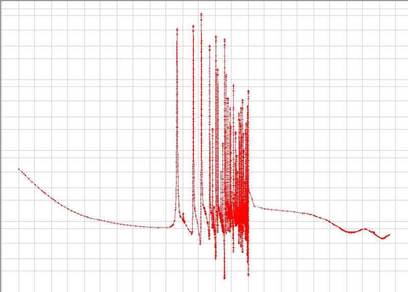

It's actually quite difficult to get the fission reaction to runaway uncontrolled.
There are many prompt feedback mechanisms that will terminate a fission power
excursion.
For example, in a light water reactor; the water coolant also serves as moderator.
If the reactor fission power starts to runaway - the water gets hotter, and hence less
dense. Its moderator function is thereby decreased - and that drops the reactivity and
hence terminates the runaway.
Additionally, there is Doppler broadening of absorption resonances. This is less
important in LWRs than the moderator effect above; but it is the primary feedback in
the IFR [ which doesn't have a moderator ].
Look at a plot of the absorption tendencies of practically any heavy material; and you
will see a series of "spikes" called "resonances" [see attached]
When the materials of the reactor heat up; these resonances broaden - because
the increased thermal motion of the material can better compensate for any
"mismatch" between a neutron's energy and the energy of the resonance - the
energy at which neutrons are most highly absorbed. This increases non-productive
absorption of neutrons; and again lowers reactivity and terminates the excursion.
