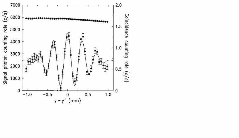

I had not seen the earlier thread on this subject from last May. So, from the Zellinger paper, and also from the Shih "ghost" paper, and from the Cramer paper (http://faculty.washington.edu/jcramer/Nonlocal_2007.pdf) the idlers clearly do have the which path information.
However, it is also true that Walborn et. al. obtained interference in their basic setup (no 1/4 wave plates) when they used coincidence counting.
Were you ever convinced by Vanesch that "one arm of an entangled beam can be made to interfere" without coincidence counting?

Even without knowing German if you look at Dopfer's thesis you can see patterns come or go depending on the set up, but never is no interferance pattern behind a double slit appear unless coincidence counting is in use.
There is already coincidence-counting in all the graphs shown in the Dopfer experiment, none show the raw data, so you could just as easily have said "never do you see an interference pattern unless coincidence counting is used"--read this page which has a description of it, which says:
The two photons produced in the crystal are not necessarily identical, but knowing the energy of one, the other then follows by subtraction. There is a whole range of output energies but the experiment chooses to look at almost equal pairs. The number of photon pairs produced is small so that they can be individually registered at the detectors as separate 'clicks'. A coincidence detector senses when two photons arrive at the same time at the two detectors, thereby distinguishing the entangled pairs from any other photons floating around. The light arriving at the upper detector, D2, will be much brighter as there is no double slit in the light path obstructing most of the light as there is in the lower path. Only the coincident pairs of clicks are recorded, all the rest are ignored.
The raw data coming from the photon detectors were not recorded, only the coincident data. The difference between raw data and coincident data would have been large for the upper D2 detector but rather small for the lower D1 detector. If unprocessed raw data had been recorded for the lower detector, Cramer estimates that around 15 % of the incoming photons would have been regected and the patterns would have been similar showing two distinct states depending on the position of the upper detector. This in itself is a remarkable discovery and needs confirmation.
I guess Cramer's retrocausality experiment will by necessity be looking at the raw data rather than coincidence counts, so we'll see if the difference between the raw data and the coincidence counts is indeed "rather small" for the D1 detector. If there is any difference in the D1 detector depending on the setup of the D2 arm this would imply a possibility of violating causality, so I guess you'd probably agree with me that it's unlikely to make a difference. On the other hand, I'd predict the raw data for the D1 detector would look more like the lower right graph on the Fig. 4, or perhaps something in between the lower left and lower right graph if the detectors are picking up a fair amount of non-entangled photons, while you would presumably predict the raw data would look just like the graph on the lower left, is that correct?
Either way, I'd still like to know what your basis is for your claims, and whether you are arguing that your beliefs are in line with orthodox QM and that Aczel, Greene and Zeilinger have all made an error in their claims about the predictions of orthodox QM, or whether you are instead arguing that their claims about the predictions are correct theoretically but that orthodox QM is likely to give incorrect predictions about this sort of experiment.

Actually, there's a paper by Shimizu et. al.
( "Quantum diffraction and interference of spatially correlated photon pairs generated by spontaneous parametric down-conversion") in which the authors get normal photons to interfere, and they get SPDC coincident pairs to interfere, but they cannot get the signal photons by themselves to interfere when they turn off the coincidence counting.

No; bruce2g provided an example that used correlation counts.
Tons of experiments include data without correlation counts on one of two beams from a PDC. As I pointed out in the prior post if no pattern was there, I have no doubt it would have been reported and published widely. You seem to think the information was there and they just ignored it not reporting it, how can you explain that. Also, just how do you get "complementarity" into play with just one photon, ie. without using correlation to connect with a second.
Without real results from a real experiment to support your view I see no reason for use to continue this further. Without that this can only become an argument, not even a rational debate as should be conducted in the threads. I’ll just stand off from this thread and allow you own view of what “mainstream” and that you and I; TRUST different people to teach QM.
Until I notice real results posted based on using a single beam from an entangled pair I am done with this thread.

I'm pretty sure the paper shows the result of both coincidence counts and the "raw data" of all photons at a particular detector--look at the more recent version of the paper here which goes into a bit more detail. The last paragraph of the introduction says:
In this paper, we present a simple method using Fourier-optical analysis for a two-photon state, considering the quantum correlation between the constituent photons. This approach corresponds to the Fraunhofer diffraction of the classical optics, and is applicable to any arbitrary object. To demonstrate the essence of this concept, we measure the diffraction-interference patterns of parametric down-converted photons through a transmission grating, as an example of arbitrary objects, by means of both one- and two-photon detection schemes.
Someone can correct me if I'm wrong, but I take a "one-photon detection scheme" to mean a scheme that looks at the total pattern of photons at a single detector without doing any correlations with the other member of the pair. If you look at the equations in the subsequent section, they define the "two-photon amplitude" in terms of a function of the form F(x,x') [equation 2], where x is a possible position for the first photon and x' is a position for the second photon, so what they're talking about is an amplitude (and hence a probability based on the square of this amplitude, which in equation 3 is written as R(x,x') and which they call the 'two-photon counting rate') for both members of the entangled pair to be found at a particular pair of locations. They then go on to talk about measuring the "transverse wave number" of each member of the pair rather than the position, for which they use the variable q (from the graphs and the definition of wave number I gather that q is just a function of position with dimensions of 1/position, and after eq. 19 they mention that the transverse wave numbers are normalized by q = 2pi/d), so that in equation 4 the two-photon counting rate for two values q and q' is written as R(q,q'). Then in equation 17 they talk about the one-photon counting rate, which they write as R(q), so it seems they're just talking about the total probability a single member of the pair will be measured to have the value q, without any correlations to the other member of the pair being used.
Then after equation (18) they consider "an uncorrelated case", and derive the "two-photon counting rate of two independent photons" (i.e. no entanglement), and in Fig 2b they show two graphs of the predicted results, the top for the one-photon counting rate and the bottom for the two-photon counting rate; both show interference. But then they go on to consider the case of correlated photons, and in Fig. 4a they consider "perfect spatial correlation", with the corresponding graphs in Fig. 4b showing interference for the two-photon counting rate but no interference for the one-counting rate. What do you think this means, if not that their theoretical predictions is that the total pattern of photons at one detector will not show interference in the case where they are entangled with the photons at the other detector in such a way that they have "perfect spatial correlation"?
Then if you look at the experimental results in section III, they agree with the theoretical predictions--Fig. 7 shows no interference observed in one-photon detection, with interference observed in two-photon detection. Also note that they ran the same experiment with non-entangled using "thermal light generated from a tungsten-halogen lamp", with the results in Fig. 9--in this case interference was observed in the one-photon detection case as well as the two-photon detection case.
Please look over the sections of the paper I mention, and if you disagree with my understanding of what was going on and think that the "one-photon detection" involved correlation too, can you explain your reasons? What do you think was being correlated with what?

I have purchased this article and uploaded it as an attachment to this post. I have separately uploaded figure 2,
which, for the benefit of RandallB, shows interference with coincidence counting, but absolutely no interference at all for the signal photons taken by themselves (I believe that you can see the straight-line at the top of the thumbnail, which is the count of the raw signal photons, though to a different scale).
Also, RandallB, please note their equation (3) on p. 1194:
The probability density Psignal(y) of detecting a signal photon at y is given by:
P(signal at y) = ... = K, (3)
where K is a normalization constant.
That is, the probability of finding the signal photon at y, when it is not coincidence counted, is a constant; I certainly hope you understand what that means : they have derived the fact that the signal photons alone do not exhibit interference.
